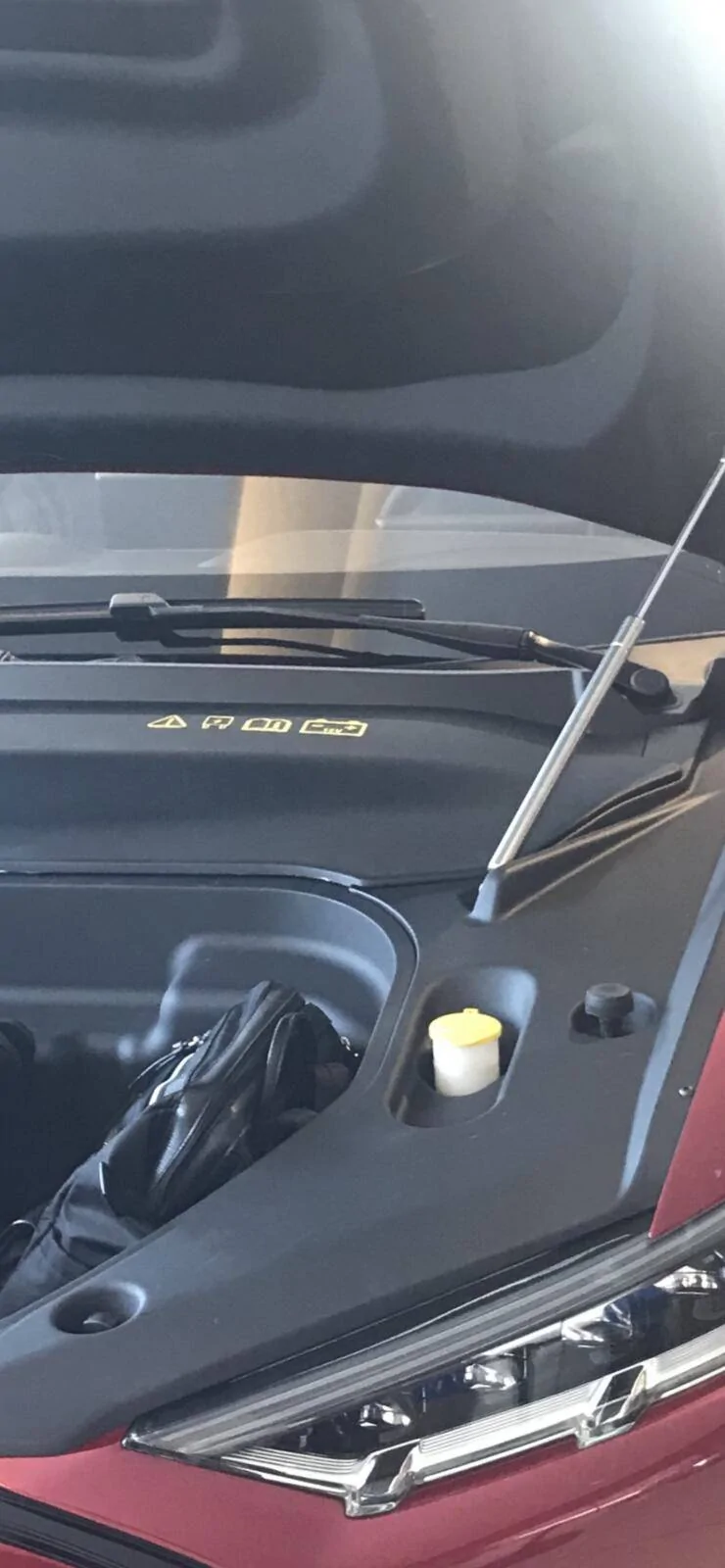

Good info in that video. Right now I keep a Li-ion jump starter pack in my glove box. Sounds like a better place to keep it in Mach-E will be in the frunk, since I might be unable to open vehicle doors while 12V battery is dead.
Further, if I can't even open the frunk, then I'd need a 12V source that I can jumper to one of the front access points. That's a bit disappointing.
At the original reveal, Ford said there are super capacitors at each front door e-latch so that they can be opened from outside the vehicle in the event of a 12V power loss. I assumed it'd have enough energy to at least allow entry through the b-pillar numeric pad. Sounds like that is no longer the case?
Being able to get into the passenger cabin would be my preference over frunk access, since the frunk can be opened from the cabin and not the other way around.
Also, I'm wondering if the tow hook 12V leads are ignored while the vehicle's 12V system is functioning properly? I hope so, otherwise they can be easily used to gain access to my emergency shrimp and wings storage supply.
Yes, I suspect the tow hook leads operate the Frunk release only. We've seen that the key fob has a Frunk release, so clearly it can be opened electronically.
Maybe you'll want to velcro the Li-ion pack behind the front bumper or something.
