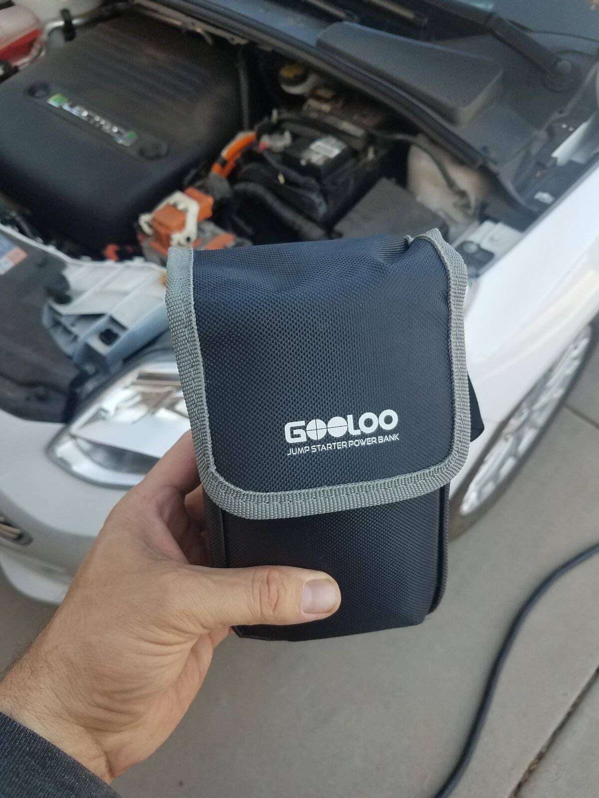

Really good question. I would keep the cables if you have other needs for it. I chose to purchase a portable jumper battery and I keep it in the storage area with the convenience EVSE and tire sealer kit. Your 120v inverter would probably fit in that space too.

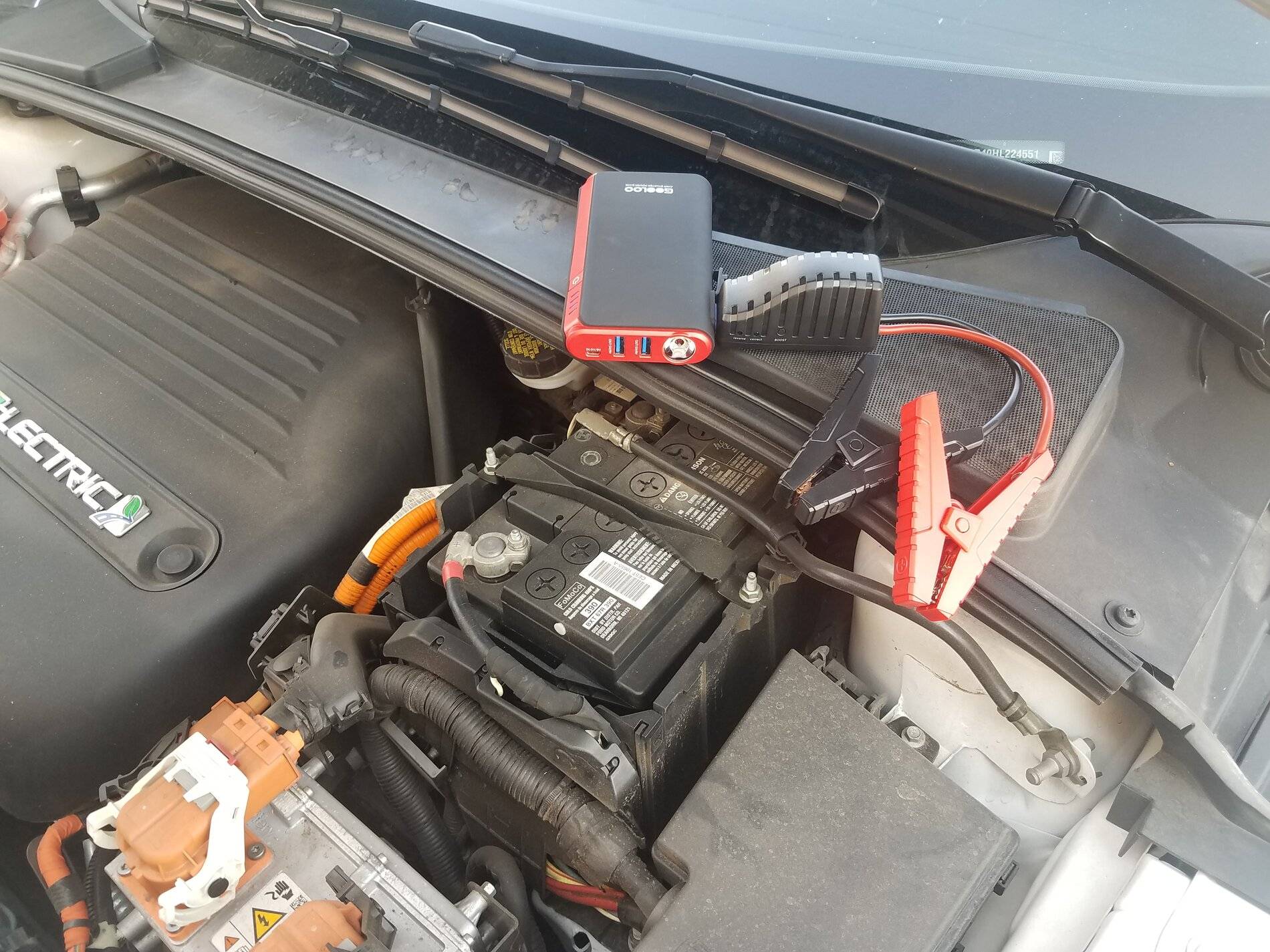

The portable jumper pack doesnt have to be high amps.....just needs to have enough boost to wake up the computer modules and then the HVB will take over (via DC-DC converter onboard)
Ford Mustang Mach-E Jump starting ICEs 20201003_143404
Ford Mustang Mach-E Jump starting ICEs 20201003_143552

Some 12v batteries fail in such a way that jump starting isnt possible no matter what size the source power is coming from. In those cases you have to physically disconnect the cables and jump the vehicle cable to cable.
Can't say I would attempt that on an EV though....maybe, if there wasnt any other choice.
I did jump start my brothers Focus Electric with that pack. It worked well. It was actually at the dealership where he bought it so we jump started it and drove around to the garage where they replaced the battery before he left the lot.
Never tried it on our Energi... ...maybe it needs more amps for some reason?
