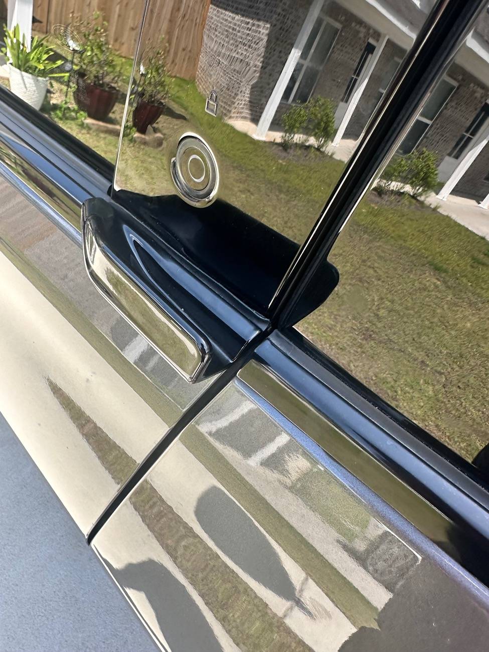

Storing it in the vehicle only does you good if the 12V battery died with the doors unlocked. If the doors are locked when it died, then you're going to have to make a phone call (unless you have a string backup).
I keep mine in my ICE car, and can call a family member to bring it to me in a situation. Worst case I might need a ride and will have to come back with the jump pack later.
Yes ? thank you Lee, it’s still there I forgotten about it cause you can’t see it outside the car.
