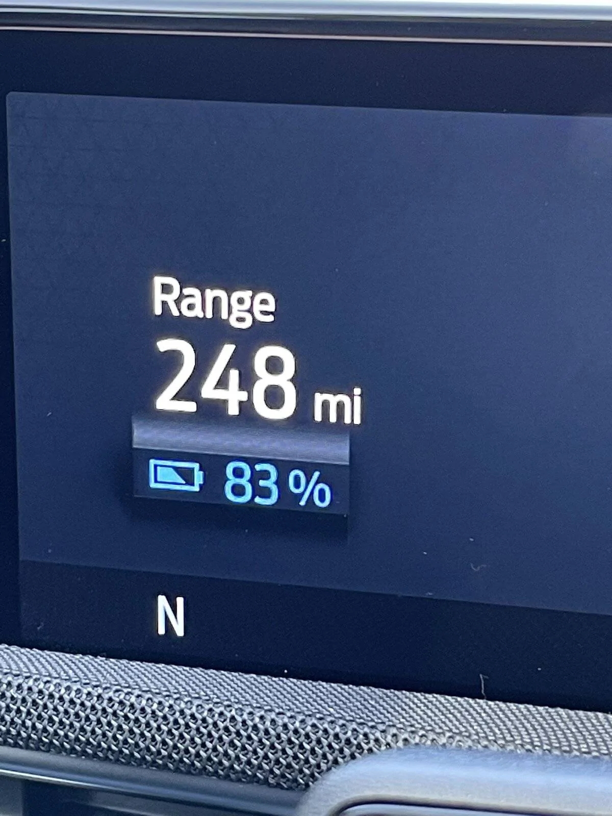

The range I've been getting shown for the past week. I've not changed my driving habits, I drive very grandpawish and last month even received 60% perfect driving! lol My commute from home to work I get anywhere between 6kWh to 8kWh. About 10 miles of freeway at 75 and then about 7 miles of 30mph or lower speeds. Also have a down hill from a bridge that might build some regen.
Its been in the low 70's here, around 55-65ish in the early mornings. I park in a garage so the temp should not be going down too awfully bad. I typically show about 265 at 80% SoC, so its a pretty big displayed drop. Really kind of interesting to see such a big drop for temps that really aren't that cold.
I will mention I've not been conditioning my car. Kids are out of state currently so my wake up time for work is kind of whenever I feel like it lol Where when kids are home I take them to school at the same time every day.

Cold weather and rain both reduce range but not more than 15%-20% in my experience over 2 winters.
My CA RT1 (RWD ext range) has lost more than 50% per GOM. In the 90s with the AC set to 65, the GOM was around 330 for full and mi/KWh was typically between 3.6 and 4.2. In the 50s with heat set to 68, the GOM is around 200 for full and mi/KWh is typically between 2.1 and 2.5
My only thought is that a lot of my trips are short, so the cabin heat never stabilizes and the whole trip is spent with the e heat coils on getting to temperature.
Dropping from 3.6 to 2.1 is a 42% drop. 4.2 to 2.5 is a 40% drop. Of course those aren't accurate numbers - first you don't know if 3.6 was about to trip to 3.7, or 3.5. In addition, many have noticed jumps, like it showing 2.8 then 3.0, but never 2.9.
Regardless, you're getting a 40% loss due to running the heat, and you can validate that by not running the head and seeing, yet operating in the same temps.

I have the same issue - 1st Edition - Europe with an announced range of 600km. I got it in May and since, never got more than 470km when fully charged. Ok by reading your comments GOP/Ford is super conservative, but here we're talking about ca 25% less than what was announced.
How not to rely on the GOP when planning a long-distance trip? And let me add that I'm not driving aggressively rather the contrary as I'm trying to beef up the GOP when fully charged - but no success so far...
267
17,933
27,936
Easy. Look at your miles per kwh on your recent trips, assuming some of that is highway, and drop it a few tenths. If you're getting 2.9, plan your trip with 2.6. If you're getting 2.6, plan it with 2.3. Make sure your first stop has an earlier alternate. By then you'll know.

Watching my consumption go from 18 KWh/100 Km (3.47 mi/kw) this summer to lately 28 KWh/100 Km (2.23 mi/kw) the difference between 68 and 5 oF it appears. Throw a good head wind in there and range is still king up here. 91 KWh and no 80% cliff would be nice before winter as Ford has mentioned may be possible? ?‍♂

In a further example of how the GOM changes without driving, solely due to temperature, on Thursday morning FordPass showed 195 miles of range. The car hasn't moved, nor has it been unplugged. Charger is powered except 11AM - 7PM M-F. As of this morning (coldest night so far), it is showing 187 miles. That's a 4.1% drop (ignoring rounding) as it sat still in the garage.
