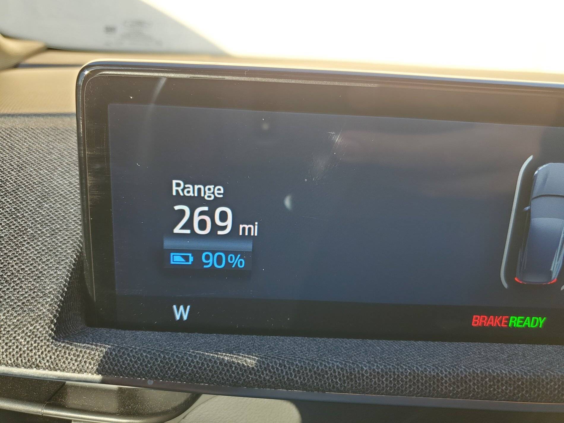

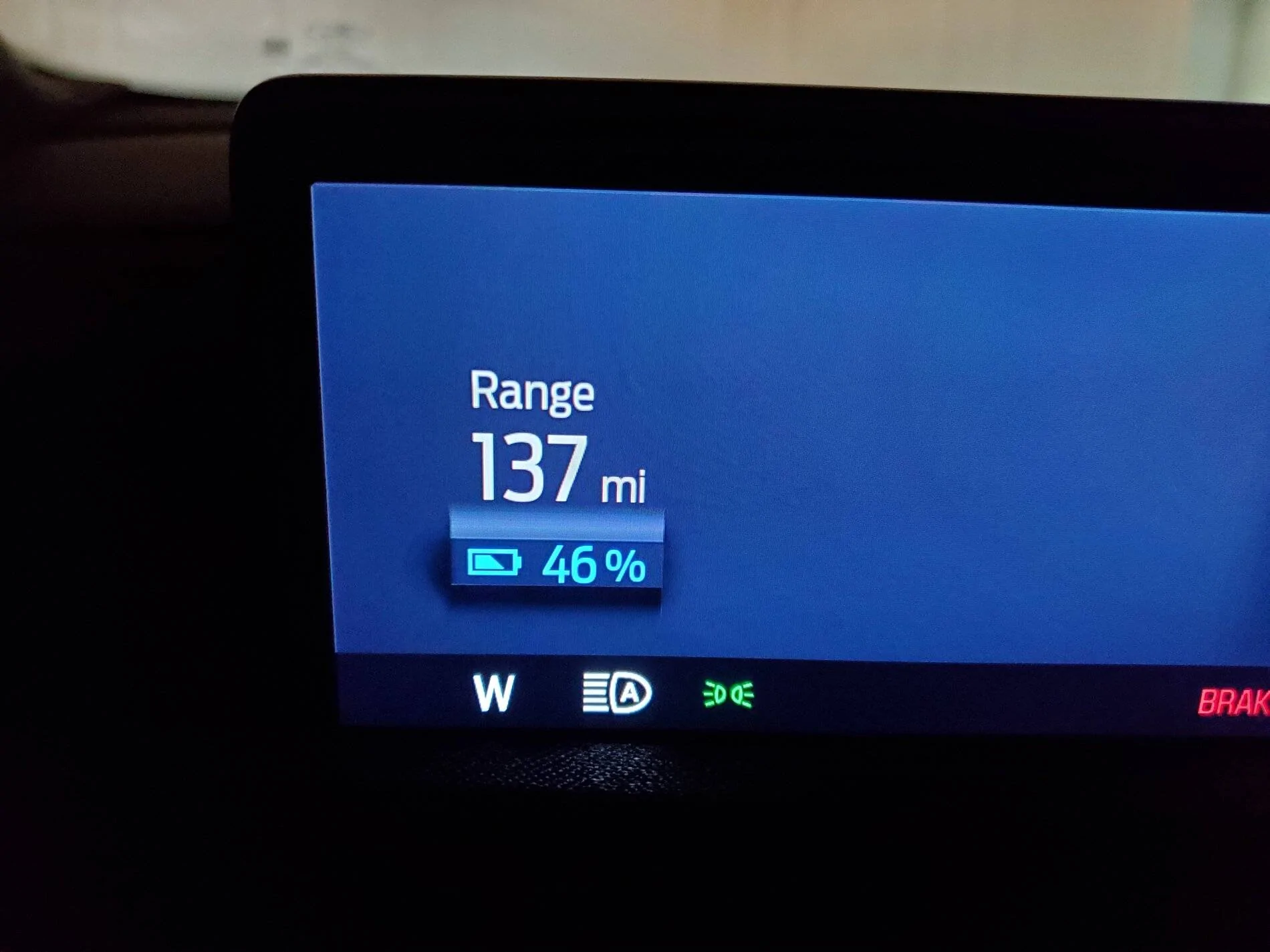

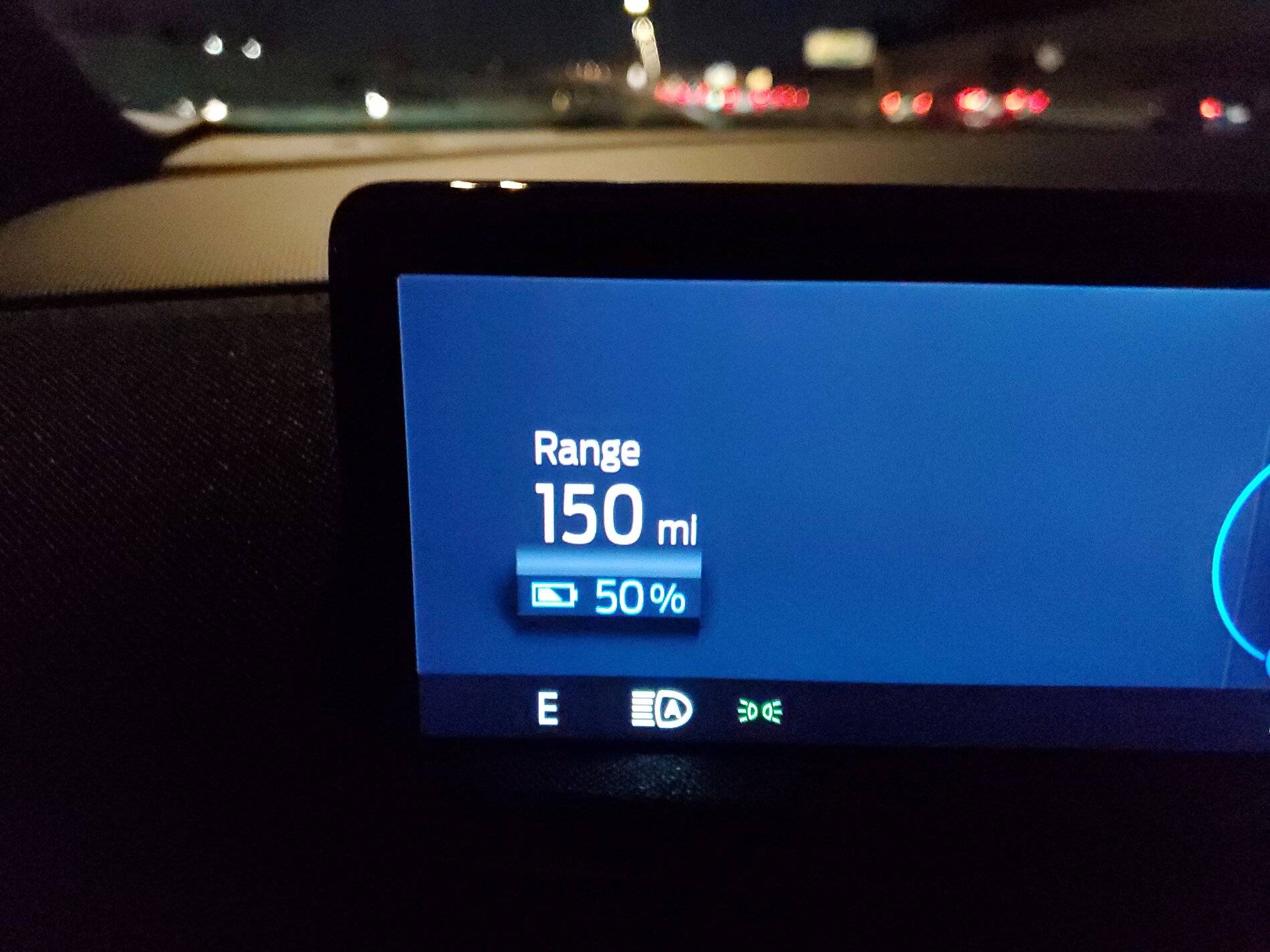

Mine estimated 269 miles until empty when I left home and estimated 137 miles when I got home. I actually drove 128 miles today so about 4 miles difference between estimated and actual. About 1.5% variance? Seems pretty close.
(Including a photo at 50% S.O.C. because that always gets my attention for some reason....) :)
