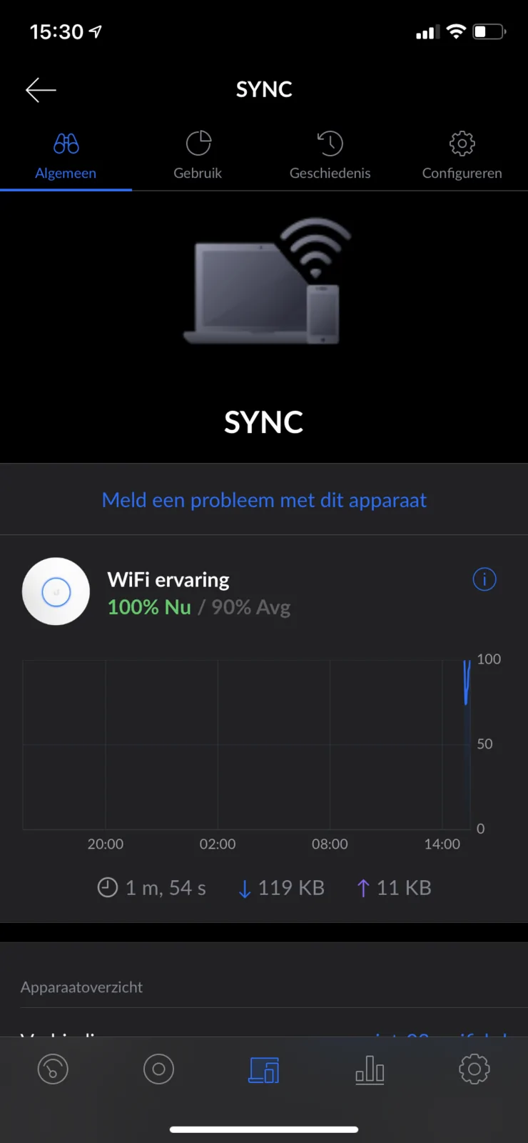

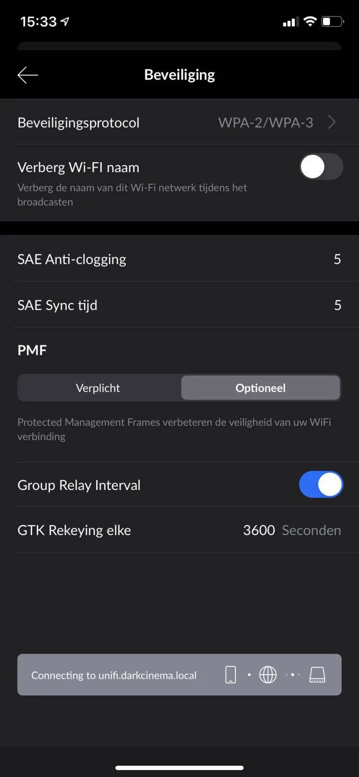

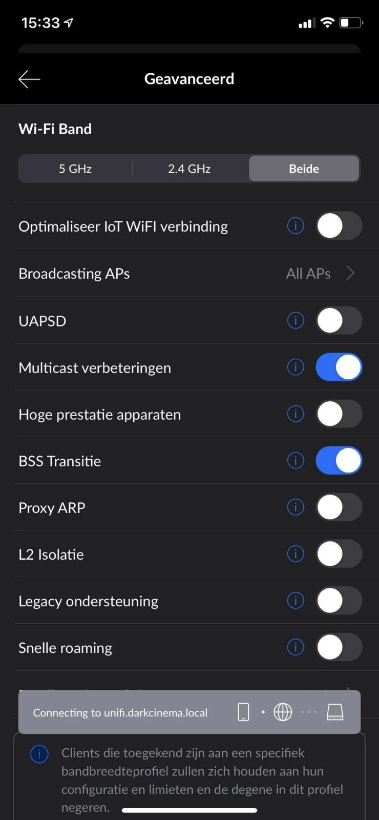

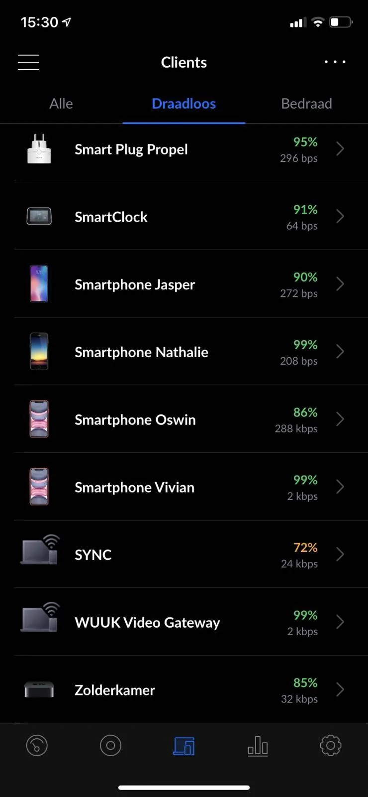

HI Mach-E owners.
I am having the same issue here. Somehow, I got it working when fiddling with the settings on my Unifi USG.
I also noticed that that SYNC4 is connecting without any issues to my iPhone hotspot.
(PS.. Since I am using the same SSID and password on my iPhone's hotspot as my Unifi network I was able to add the WIFI connection to SYNC4)
I noticed on the Unifi Logs that “SYNC” was continuous disconnecting but without enabling debugging and involving Ubiquiti I cannot tell why it keeps disconnecting. But before I go this route I tried changing some settings.
I enabled WPA2/WPA3 instead of WPA2 only and enabled BSS Transition and SYNC got connected.
I will test this to see if it is consistent, if not I need to do some debugging, but it is an issue with the SYNC4 WIFI client for sure.

Be sure to read this alternative thread of Unifi users who report that utilizing the Domain Name advertisement in DHCP replies is, in fact, the culprit. I encourage you to continue to experiment changing only a single variable at a time to assure that enabling WPA3 didn't do some other unexpected thing (such as clear the Domain Name) that was the real root cause. Please let us know as you continue to debug! (P.S. I strongly suggest running a tcpdump on your Unifi access points to capture all packets to/from SYNC on your network to confirm when you find the fix)

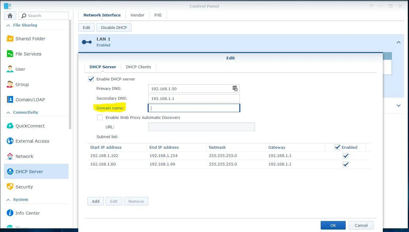

There has been a very long thread about the MME not connecting to particular wifi networks, but I can't find it right now.
Bottom line was; There are some DHCP servers with which the MME doesn't want to deal when the domain name DHCP parameter is set. Leave that blank and your MME connects just fine.
Ford Mustang Mach-E Wi-fi connection issue - Solved allowing WPA 1629987352670
So before doing anything rash, check this fix first!

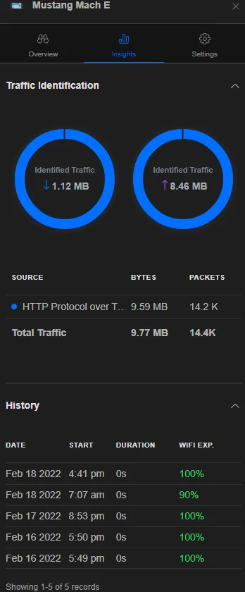

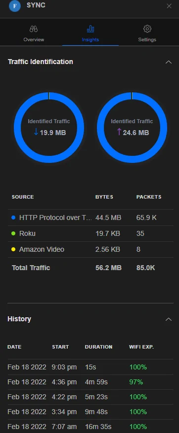

I know I am resurrecting an older thread here but I am curious what kind of traffic do you Unifi guys see when your MME is connected? My Select connect but I never saw any traffic. Now that I have my Premium I am seeing minimal traffic, it seems to connect when I get home at night for a few seconds / minute and that is about it. I've never received any OTA updates.
TheSteelRider
Dec 31, 2019
57
1,296
2,309
United States
'21 Premium RWD
There should be TWO different MAC addresses connecting, one from Sync, and the other from a separate modem connection (which might be the gateway module). Somewhere else on this forum a long time ago (likely around the same time this thread was created), a user posted what the difference was, you might be able to search and find it.
Here is what the traffic inspector with Unifi Controller v.6.5.55 says about the two connections
Sync:
