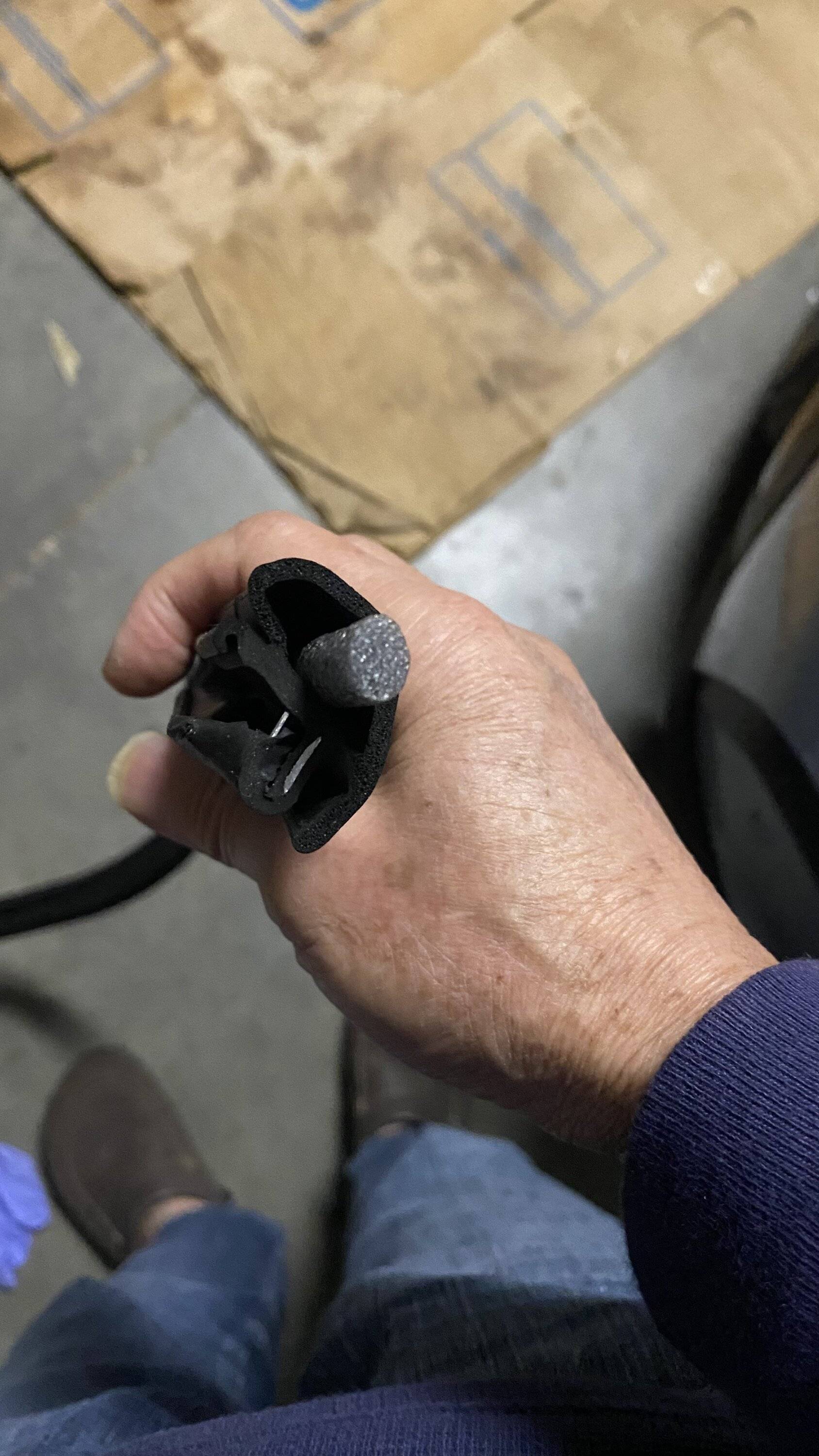

It helped a little bit, but the noise seems coming from the door. The weather strip feels too soft to form a tight air shield. So I decided to insert the same backer rod in the cavity of the strip to make it tougher
Ford Mustang Mach-E Wind noise 07E032DF-66A8-4D9C-8ABD-801916A38239
At 86 mph the noise did drop. The only thing is now the door is bit harder to close. A thinner rod sure will make it easier to close. You have to find the one can cut the noise and close the door easily.

If the window is open then the door does close easily. The only explanation I can think of is that the door is now pretty air tight.
