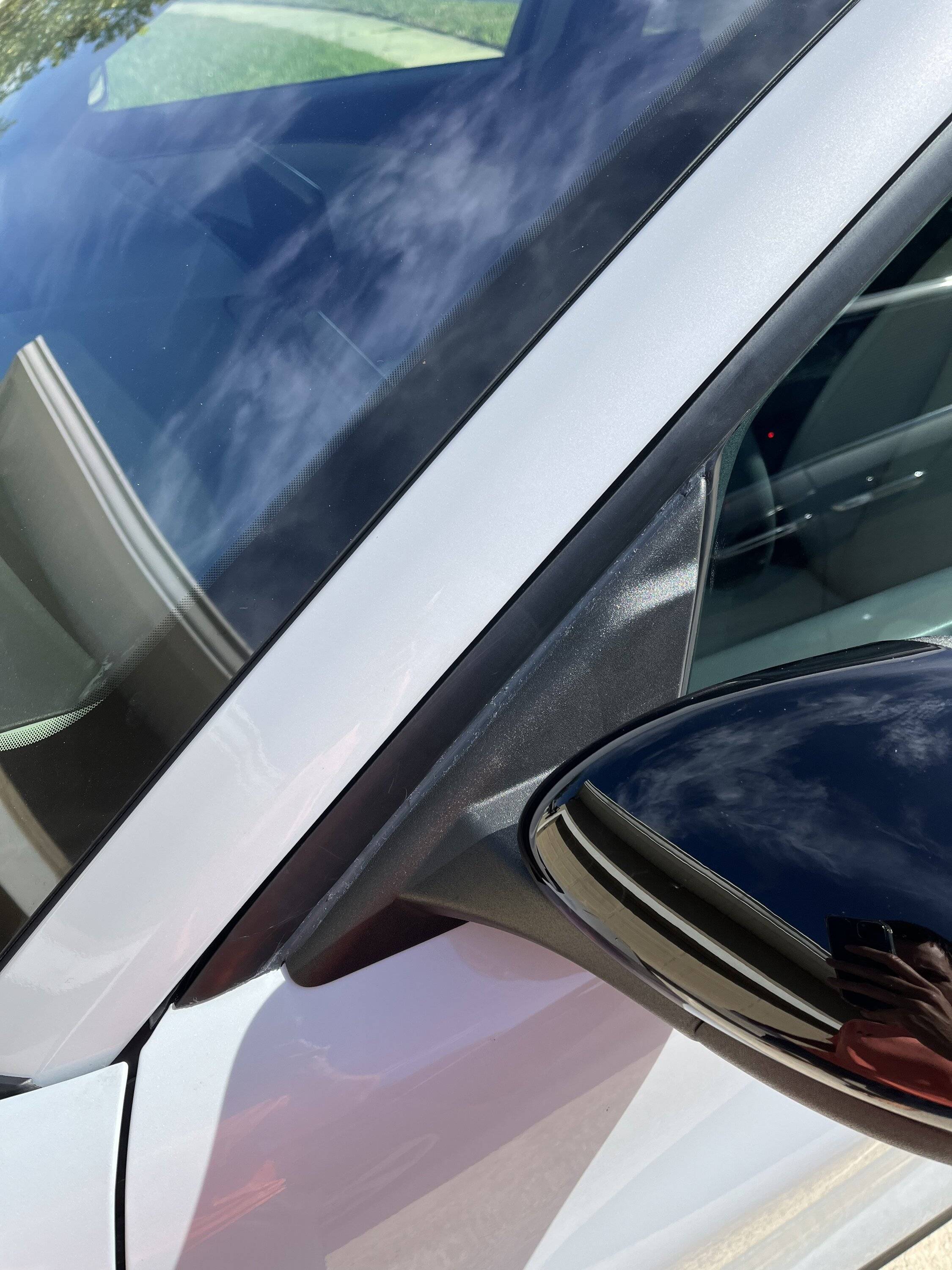

Just got mine fixed! I’m so excited. Had this from day 1 on my 22 Mach e premium. Went to greenway ford in Orlando to fix. They reprogrammed the window module to make sure it closed properly. Made it better but didn’t fully fix it. They then taped off the mirror and piece by piece removed tape until they found out what was causing the noise. It’s the gap/seam where the mirror connects to the car. They filled this seam and the noise disappeared! Drove 80 mph on the way home with no radio and no ac and only heard typical slipstream. I can finally enjoy my car!!

Do you know exactly what part of the mirror needed the tape, and what kind of tape was used? Is it something that seems like an average user can do, or did it require disassembly of the mirror unit? Would love to give this a try.
They didn’t have to take apart the mirrors. It’s literally that bead of sealant between the mirror and the door in the picture. Where the plastic from the mirror is meeting the window seal.
What did they use to fill it? Or just any clear silicone?
Not sure. I didn’t ask. It actually seemed like it had a black tint. I know it looks clear, but it def has black to it. They said they’re going to push the fix up to Ford for a service bulletin so others can apply same fix. I said the people in the forums would appreciate that because there’s plenty of us with the issue!
I did a test run today by just taping that area of the mirror (prior to doing the silicone). It made a considerable difference in my opinion. I have been following this thread for months and I knew eventually someone would get to the bottom of this. I too took my car into the dealer. I think they attempted to look at it, but they said they drove another 22 and it did the same thing, so therefore just the way it is. This has been one of the final issues with my car that just drives me nuts, so glad there appears to be a resolution.
Are you going to take to the dealer to fix? I still think it’s a tolerance issue and based on others’ experiences, it sounds like only some of the cars have the issue. Id still love to reach out to Ford to get a permanent fix. Don’t get me wrong, the seal doesn’t look bad and it fixed the issue. And I’m loving driving it. But it’s still annoying that the dealer had to do something extra to fix the car and that cars are rolling off the Line with a quality issue like this to begin with.
Ford Mustang Mach-E Wind noise IMG_1719
Decided to test this. After taping the seam, there was a small improvement in wind noise of 1.3 dB @ 70 MPH. The quality of the sound was also improved slightly, sounding a bit more laminar with less buffeting.
Overall it’s not nearly as significant as my roof wind noise I recently solved, but perhaps on other Mach-E’s the mirror gap sound could be louder than my car.
