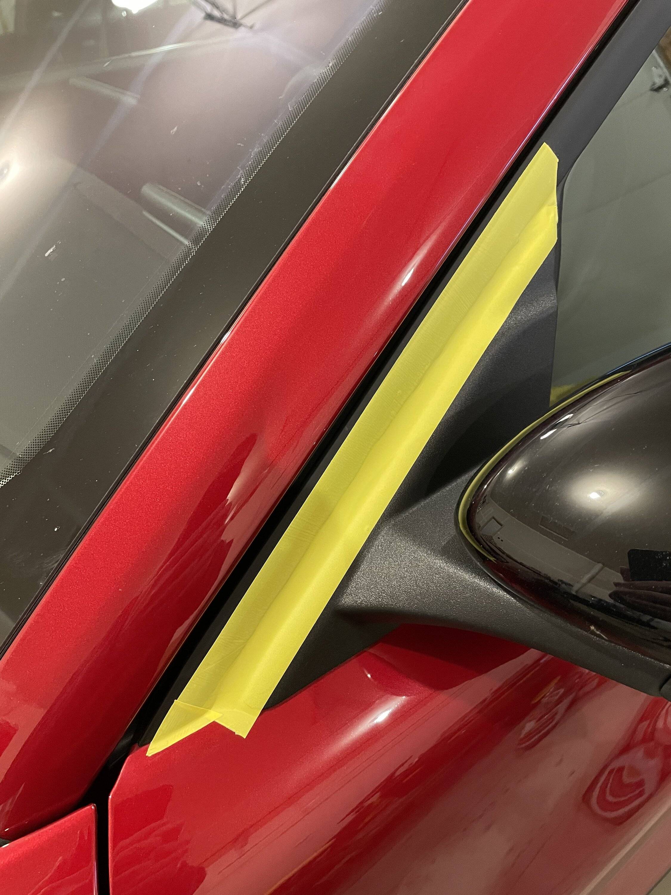

Decided to test this. After taping the seam, there was a small improvement in wind noise of 1.3 dB @ 70 MPH. The quality of the sound was also improved slightly, sounding a bit more laminar with less buffeting.
Overall it’s not nearly as significant as my roof wind noise I recently solved, but perhaps on other Mach-E’s the mirror gap sound could be louder than my car.

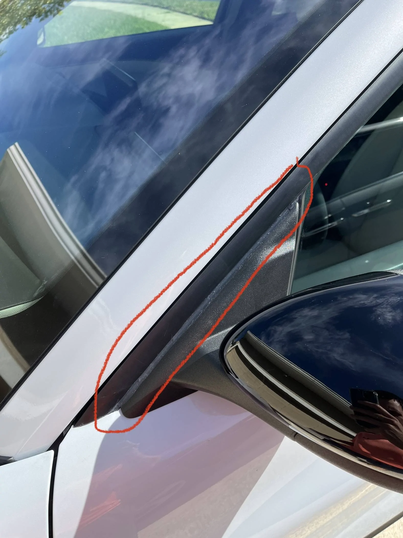

They didn’t have to take apart the mirrors. It’s literally that bead of sealant between the mirror and the door in the picture. Where the plastic from the mirror is meeting the window seal.

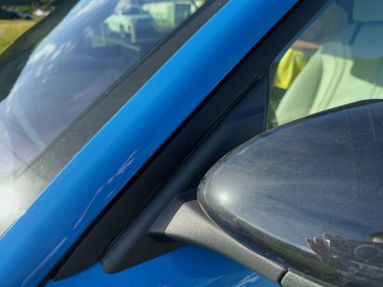

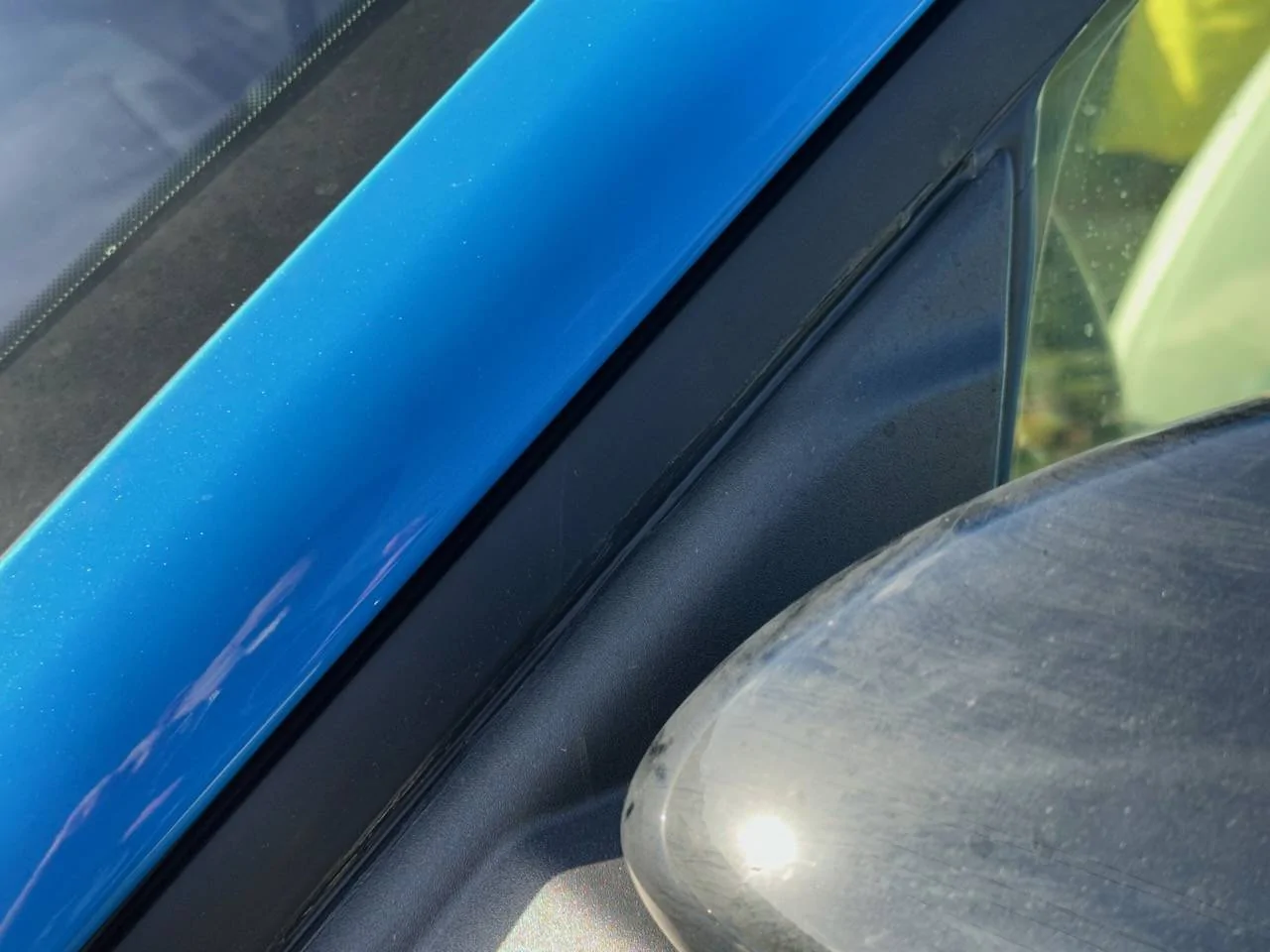

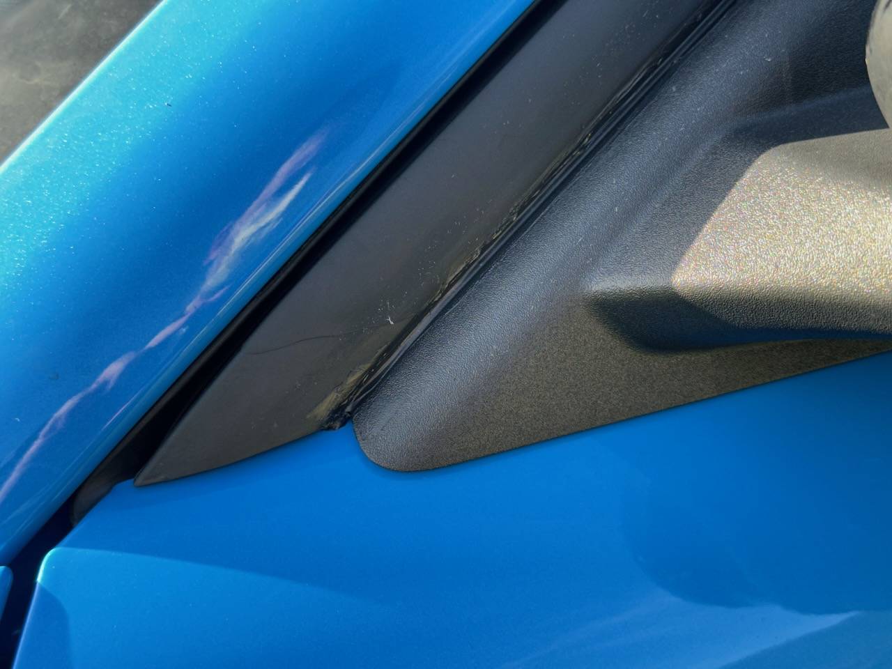

I used DAP Dynaflex Ultra (black) from Home Depot, which I had laying around for another project that never ended up happening. I already had a caulk gun, but admit that this was my first time ever using it (or using a caulk gun, in general). Here are some closer views:
Ford Mustang Mach-E Wind noise IMG_3450D
Ford Mustang Mach-E Wind noise IMG_3451D
The material was a bit under 48 hours dry in these photos, and while the instructions say it's good to go for water exposure or painting after one hour, it says it might take 7-14 days to fully cure. In artificial light you'd be hard-pressed to tell it wasn't part of the car from the beginning. In sunlight it looks glossier than the surrounding materials, but I'm guessing the shine will disappear with age and weather exposure - and it's not very obvious even now, unless you're looking at it up close.
If you go this route, the total fix would cost you under $20 from Home Depot (cost includes a caulk gun, the DAP Dynaflex Ultra in black, and painter's tape). I admit that I was in a bit of a rush and did not use painter's tape to protect the siding and the paint, instead choosing to wipe the excess off with a wet paper towel - not as ideal, ideally you'd put tape down on the sides and over the bottom paint (might be difficult but should be doable). I also didn't clean the crevice, but ideally you'd clean and dry it first. Squeeze out the material with the caulk gun, tamp it down a bit, wipe away any excess, and then remove the tape before everything completely dries. I let it sit for about 36-48 hours before driving the car. Even though it looked like I had way too much on there and wiped off a fair bit, the material seemingly sank in a bit and there is a small crevice. I could put a second layer on there to make it completely even, but based on my test drive today, this has completely resolved the issue for me and I don't feel the need to do it.

The windows moving up slightly is normal and is not the issue. Try taping the mirror trim as shown.
