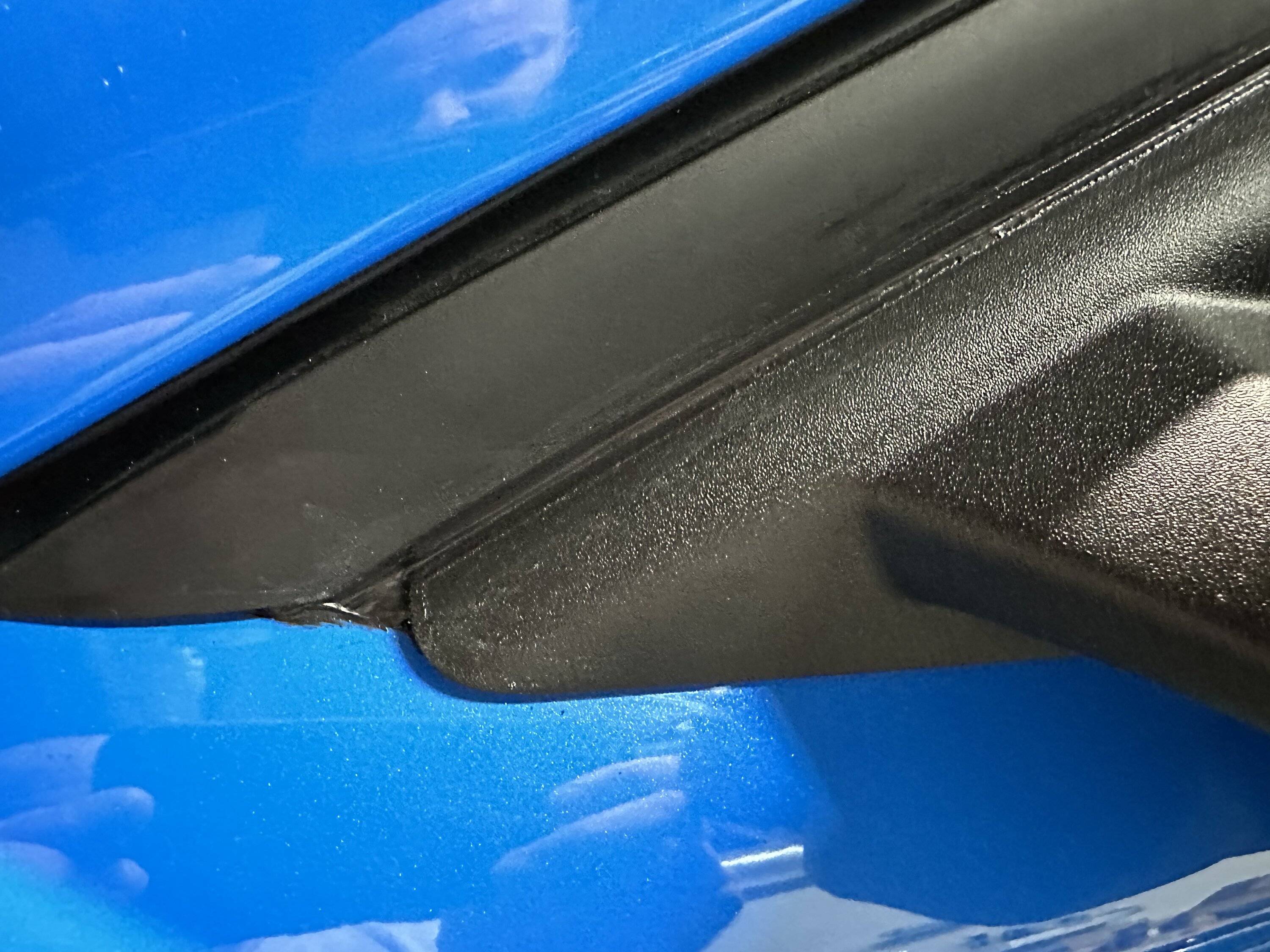

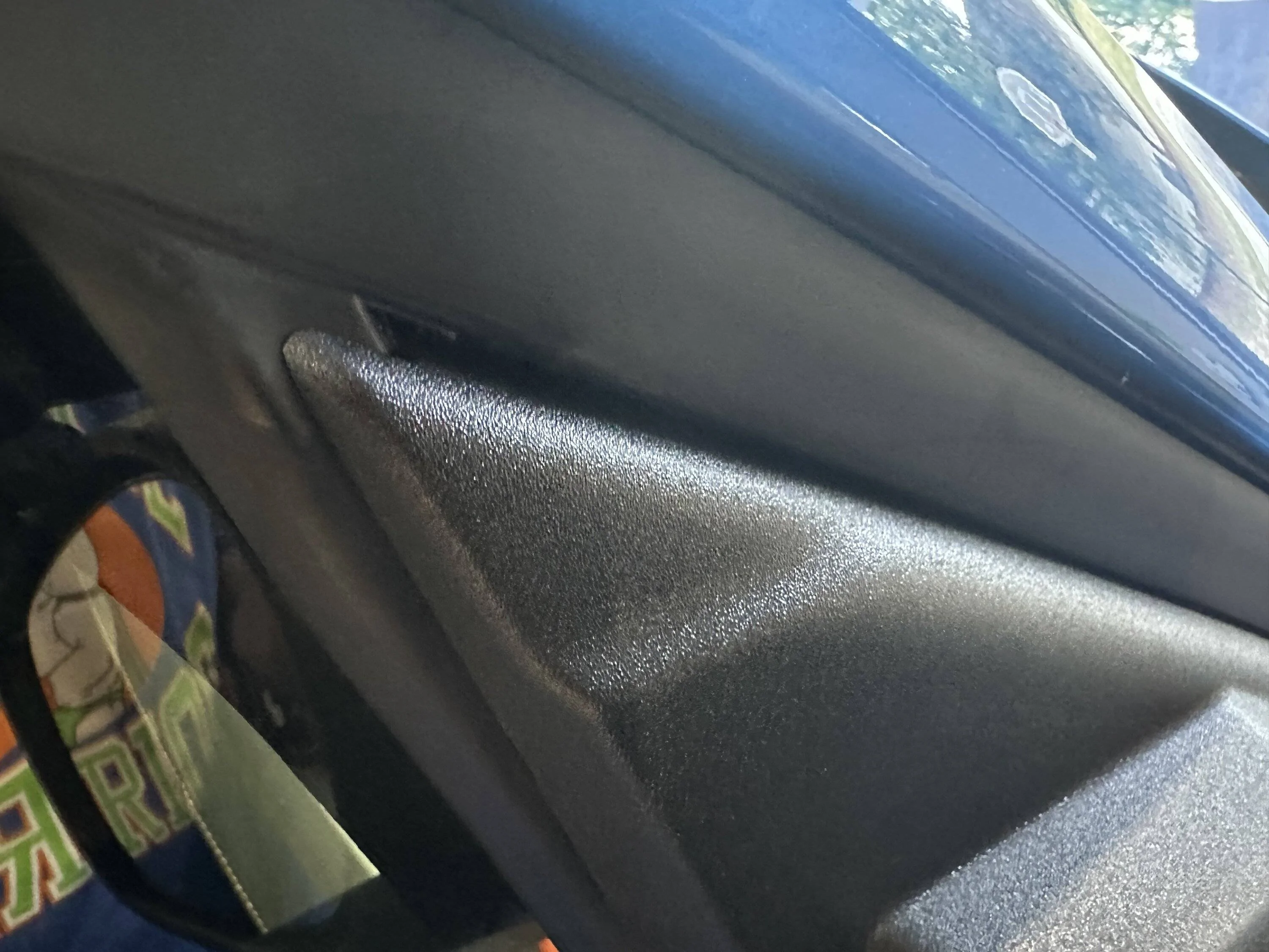

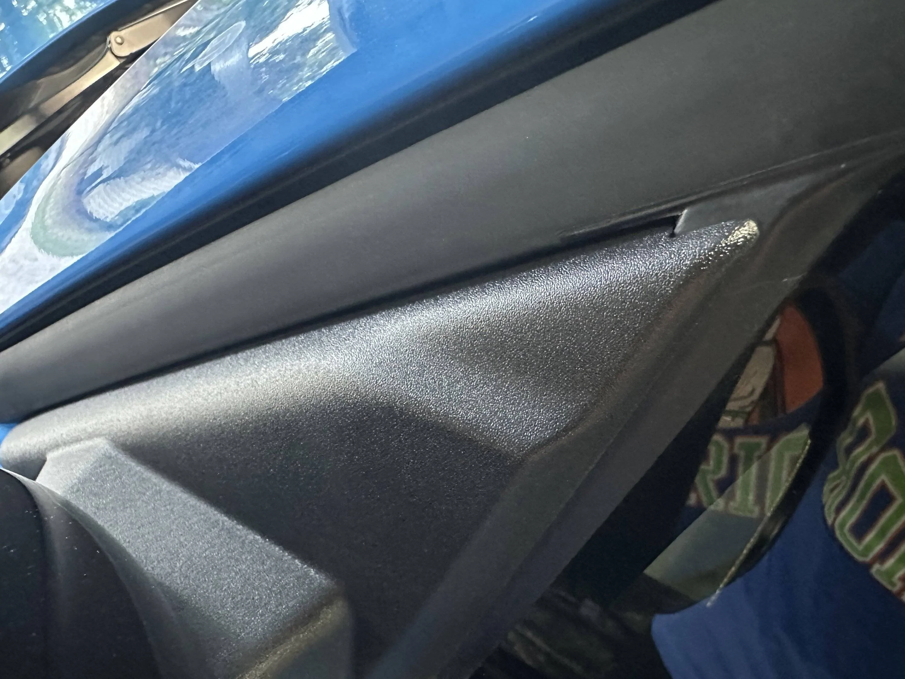

I’m so glad I found this thread. My dealership is one of the ones that says “oh, you’re just noticing it cause you don’t hear engine noise.” Which is the absolute dumbest excuse ever. First of all, I’ve driven EVs and Hybrids for years. Secondly, engine noise isn’t all that loud at cruising speeds. Yes, it gets loud while you’re accelerating, but come on… you could hear this wind noise over the sound of an engine even.
After seeing this thread, I took it upon myself to apply the fix that the lucky poster had their dealership do (must be nice to have a dealership that wants to listen and help).
For those wondering what to look for, there is a 1/8”+ gap between the plastic trim of the side mirrors and the gasket. Most cars I’ve owned have the mirror trim pressed against that gasket, or was tucked under it. However, on the Mach-E, Ford was like “meh, close enough.”and left that gap. That gap is the perfect spot for wind to creep into and make all sorts of noises.
For what it’s worth, I made my best effort in seeing if I could reseat the mirror, but I could not find a good way to do that.It appears as if Ford just didn’t measure the height of the mirror trim well enough.
I applied the black silicone that was linked to earlier in this thread. I tapped off the mirror trim and the gasket, then ran a like of silicone into that gap. I used my finger to run down and remove any excess leaving a smooth line. Then carefully removed the tape and let the silicone cure for a few hours before taking it for a spin.
This trick completely eliminates the wind noise coming from the side mirrors.
Here’s a photo of the gap:
Ford Mustang Mach-E Wind noise IMG_0682
Ford Mustang Mach-E Wind noise IMG_0683
Ford Mustang Mach-E Wind noise IMG_0684
You can see in the last photo, the passenger door had a very large gap, whereas the drivers door was a bit smaller. Both produced the same wind noise.

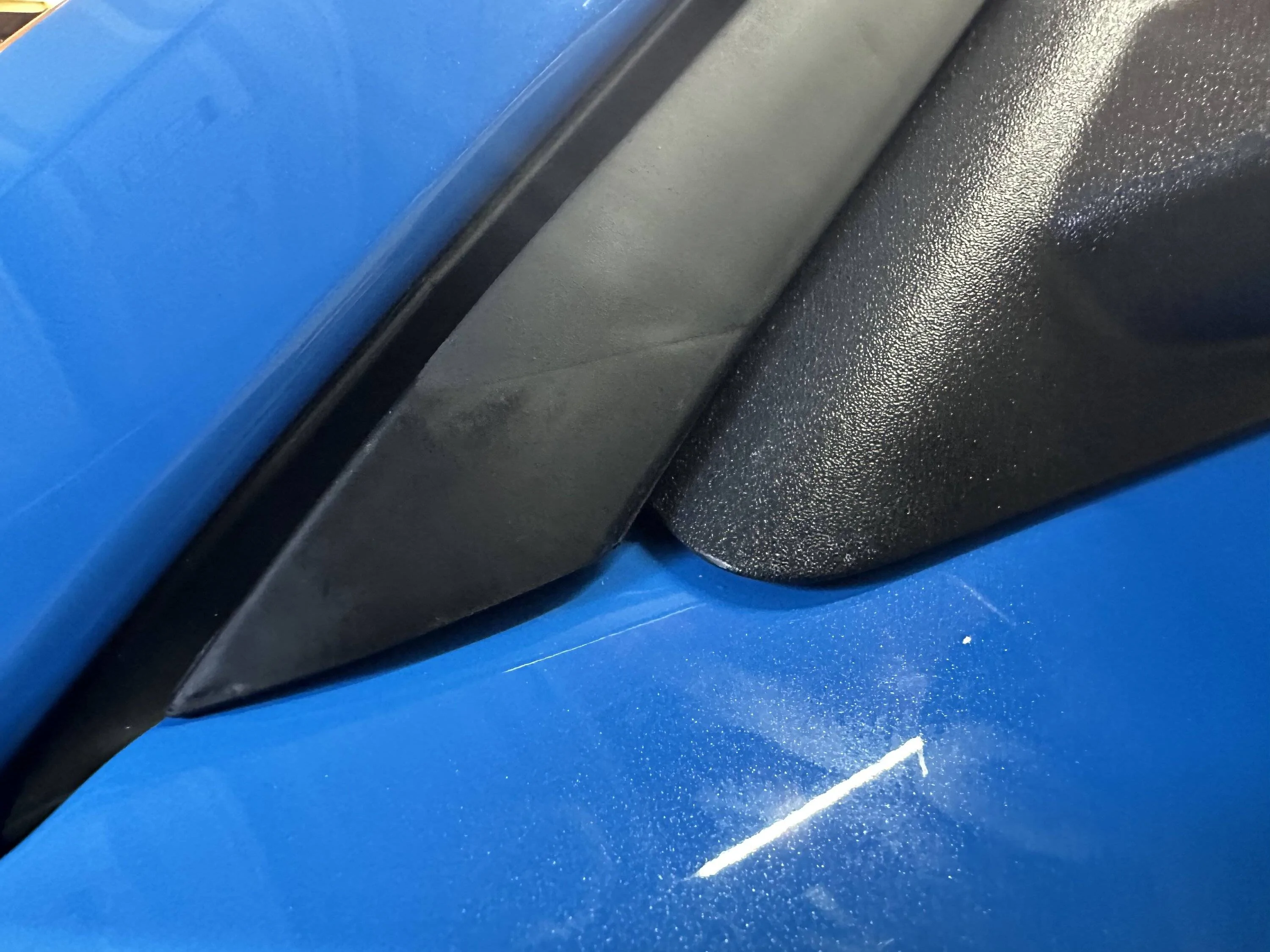

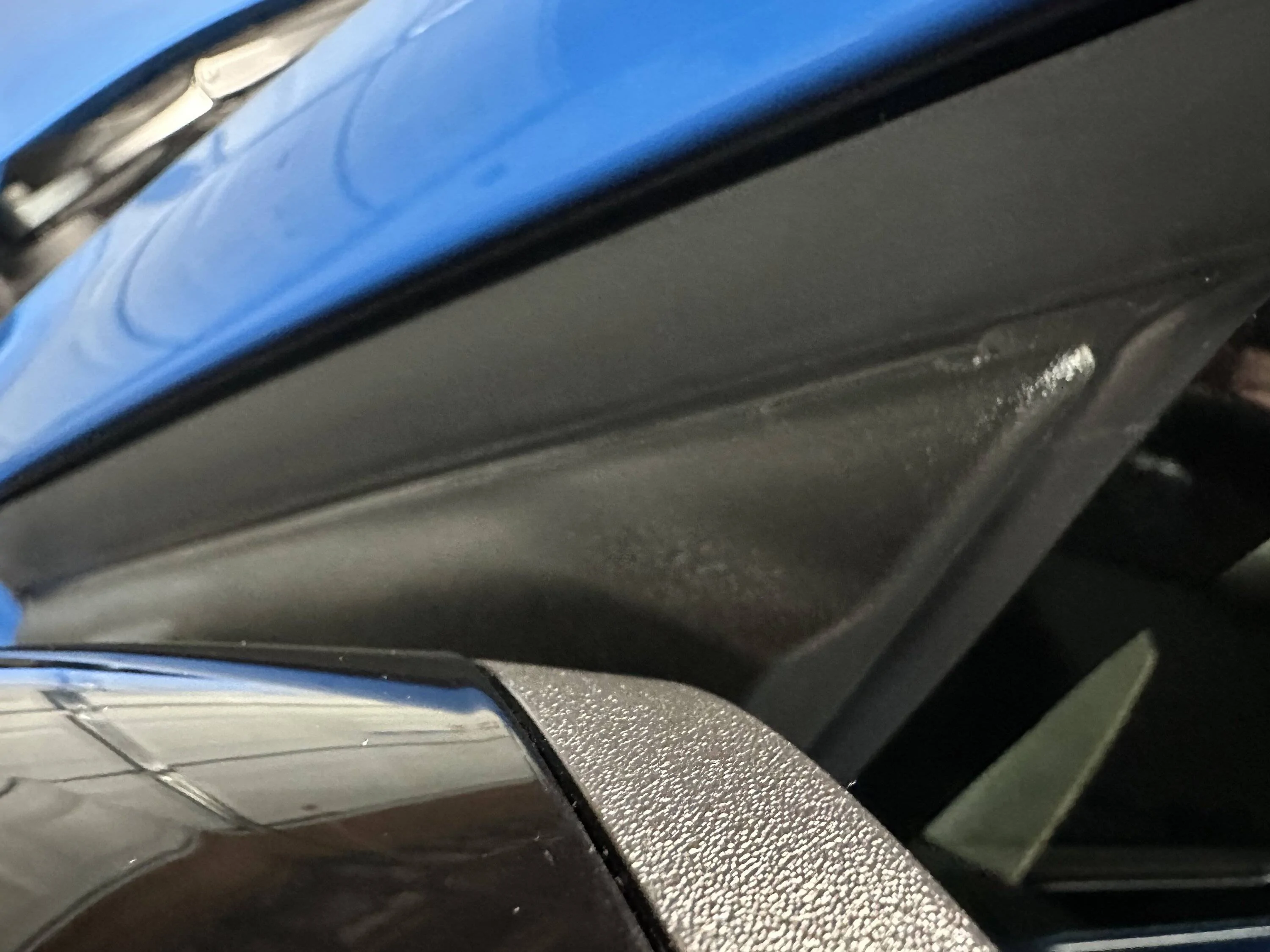

Here’s a photo of it filled with the silicone after some curing time:
Ford Mustang Mach-E Wind noise IMG_0686
Ford Mustang Mach-E Wind noise IMG_0687
It blends pretty well and is not noticeable at all in person. I feel like this is a hack, but a good hack. I wish Ford had better quality control for a $70k car.
