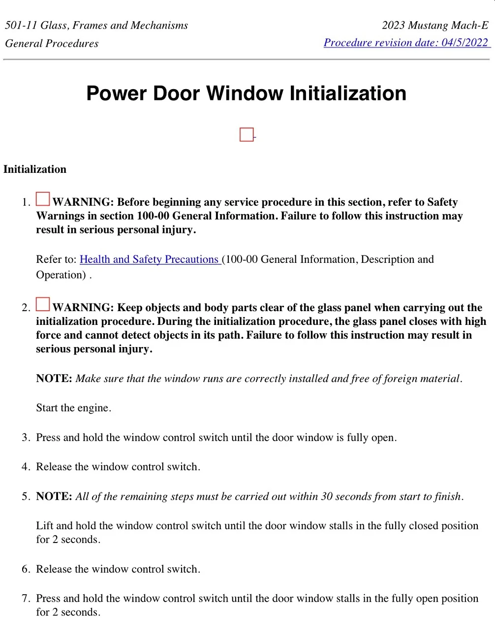

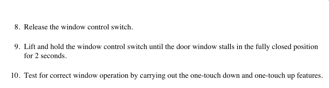

Do a search, you can fix this if you "reset" the switch.

Does anyone else have this issue? If my drivers side window is rolled down some and I want to close it, it rolls down instead of up? Once it goes down it will then allow me to roll it up. It’s super annoying when it’s raining. It doesn’t always do it, but will randomly.
From the repair manual:
Ford Mustang Mach-E Window goes down instead of up Screenshot 2025-09-12 at 3.11.04 PM
Ford Mustang Mach-E Window goes down instead of up Screenshot 2025-09-12 at 3.11.21 PM
