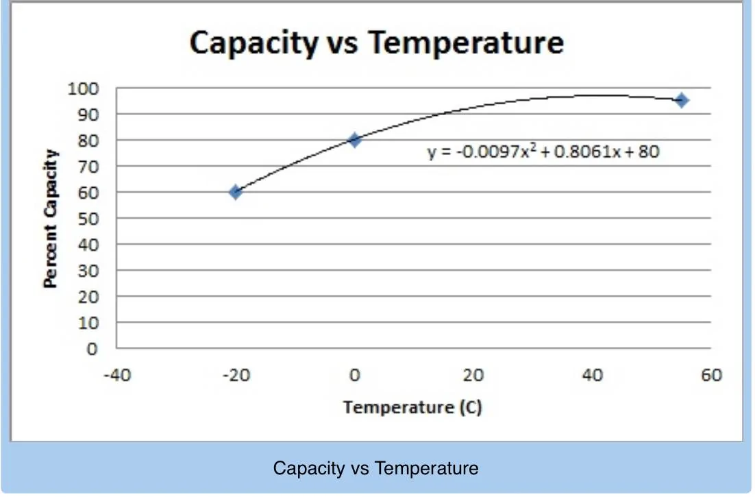

Maquis
5,696
8,083
FWIW, battery capacity vs temperature is a curve. There is not an ”optimal band” where capacity is unaffected.
This a typical Li-ion curve, not specifically the MME battery.
