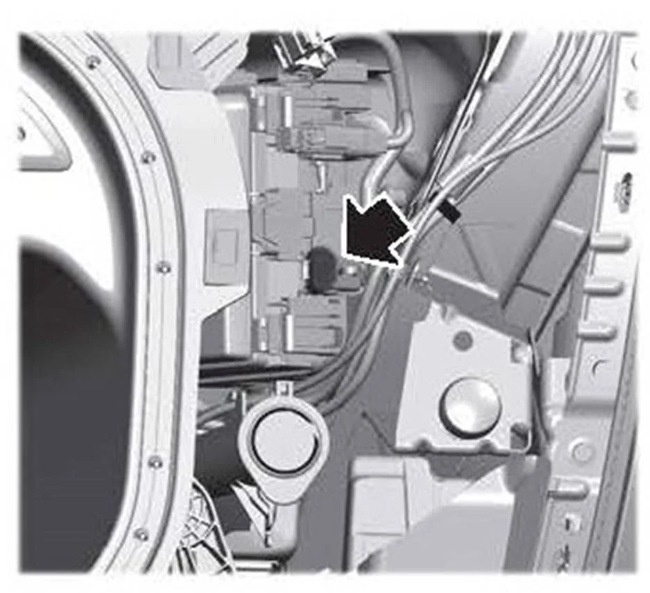

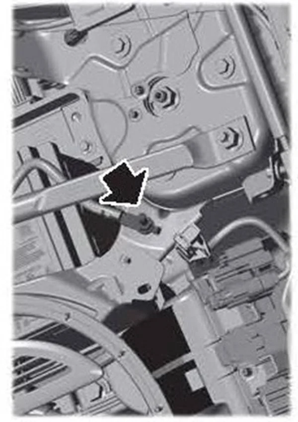

I connect my inverter with very heavy-duty alligator clamps to the areas noted on these drawings.
Ford Mustang Mach-E Wire a large inverter? Picture3
Ford Mustang Mach-E Wire a large inverter? Picture4
alligator clamps don't have much surface area in contact.... ok for temp use, but not extended high current. much better to install d-rings at posts, perhaps with suitable big Anderson disconnects rated for 150a
