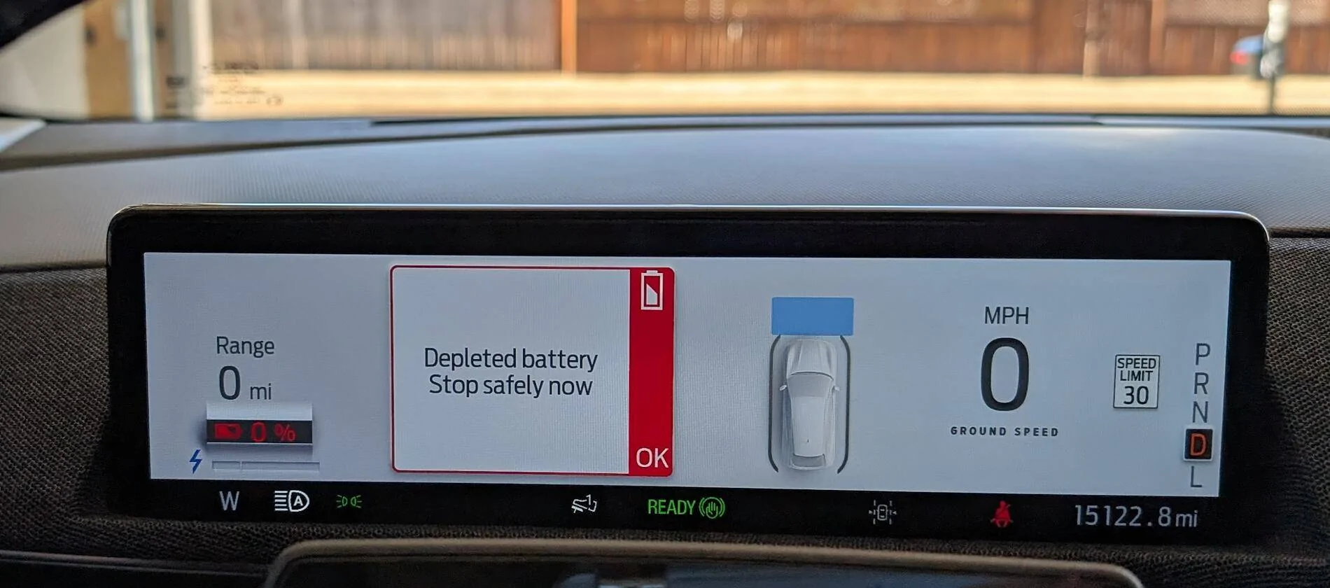

Ford engineers the car to protect the battery and never lets it go to actual zero. You need to get this message and then let it sit for almost a month while it naturally drains to actual zero before you cause any damage. Ford has several defenses built into the battery management to protect against this kind of abuse.
Ford Mustang Mach-E 0% Battery watch out!? 1740586414520-9q
https://thedriven.io/2023/04/04/deb...-charging-more-fud-from-fossil-fuel-industry/
As a final note: the only true way to flatten an EV battery below its absolute minimum is to park at a low point and then leave it that way without recharging for weeks to months as it will slowly self-discharge to a dangerously low level. Even then, the car will at a certain point defensively shut all systems down to slow the process.

Ford changed the software to add turtle mode when the battery gets low or cold. So just because you were able to drive past 0% in the past does not mean you'll be able to today. Depends on software level and how cold your battery is.
"Zero means zero" should be your mantra unless you like drama.
