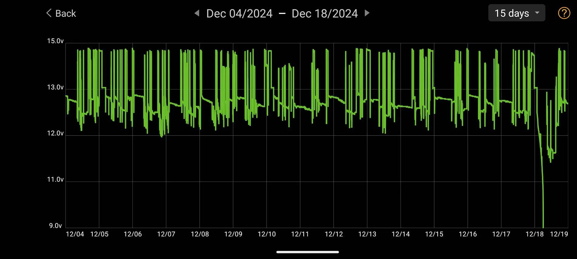

After the first episode, I bought a Bluetooth battery monitor.

One the the Mach E did better than Genesis was if I forgot to disconnect my vLinker, I'd get an app alert about a battery drain issue.
Even with the my Bluetooth battery monitor I still got surprised when unplugged the GV60 and the powered charge door wasn't closing.
The car seems to go in a strange constant 13v state which is above resting battery voltage but below the ~14.5v charging voltage, had a sharp drop, then a rapid discharge curve to 9v when the monitor stopped reading/recording.
At 11.75v, I think it would safe to send a battery SOS. At that point it's urgent and should be almost zero false alarms.
