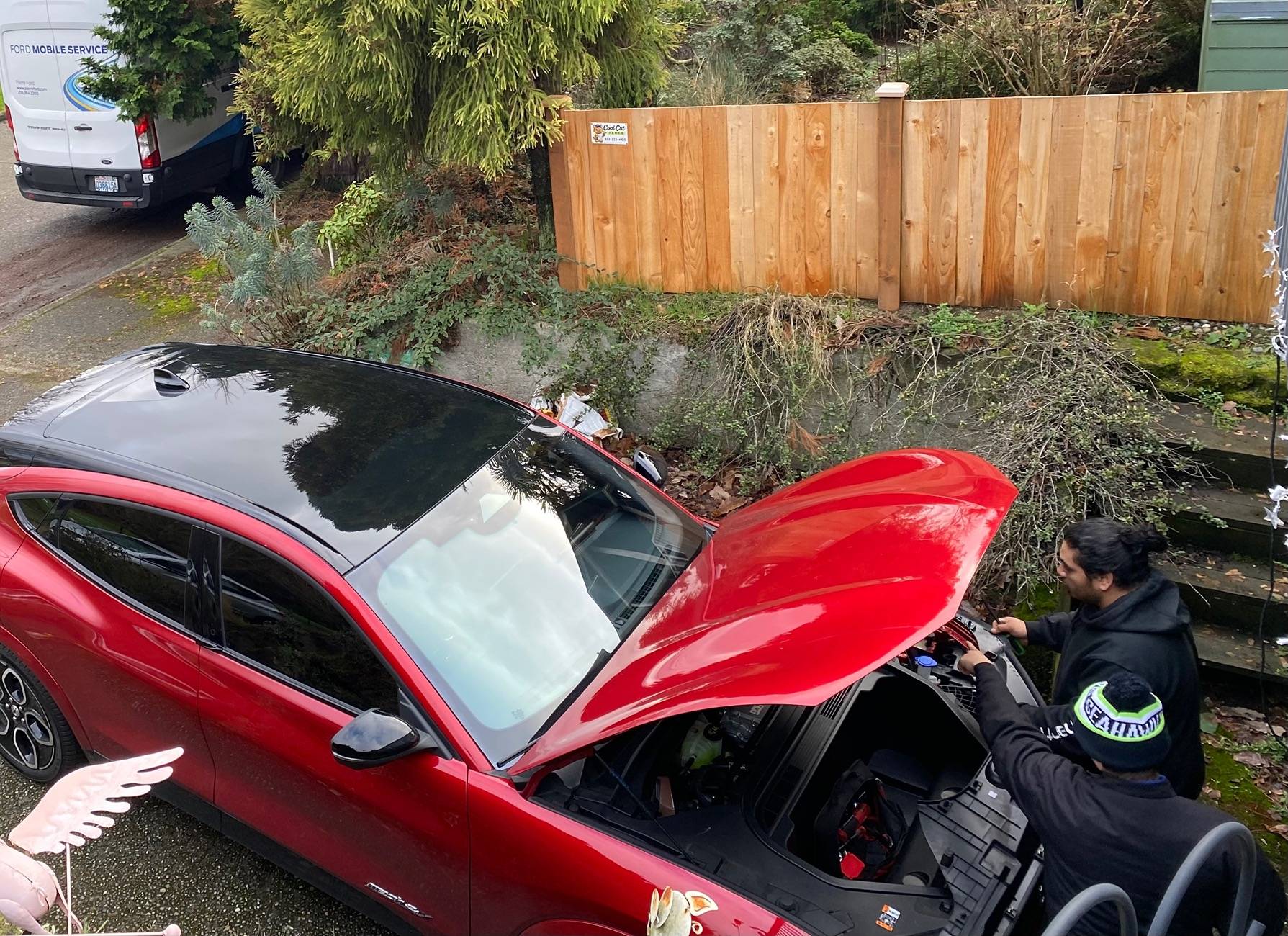

Is it best that I go to a dealer to get the 12V replaced or can any shop (Les Schwab?) do the swap?
I have a 2021 and this whole thread about the 12V Boogeyman spooked me into getting a new battery yesterday!
I called Pierre Ford and they sent their mobile techs to swap in a new battery the same day. The cost was identical for mobile service as it would be to waste a day at the dealer. It was a no-brainer and I love this service!
