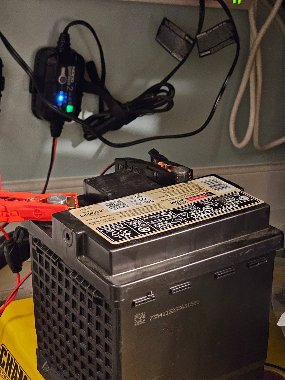

I am getting my battery ready for installation this weekend. It took about 3 hours to get fully charged, but I am going to leave it connected until I am ready to install it. And then I will immediately do the BMS reset.

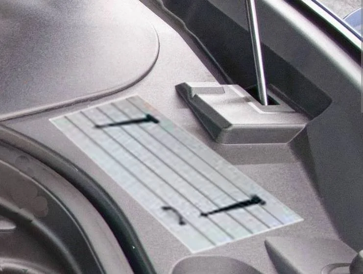

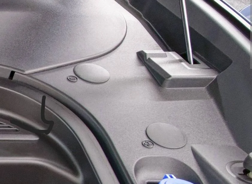

I'm surprised someone hasn't made a new panels with a door for easier access to the battery. At least for jumping the battery. Ford should create a new mold for a panel to replace the stupid design they have now. EV have less part then an ICE car but they couldn't figure out and easy access to the battery? I rather have less room in drunk but easy access to my battery.
88
12,946
17,394
You mean like this? ??
Ford Mustang Mach-E 12V Battery - Something has to be done! IMG_5082

Why
Still no way to easily pull the battery out, lol
Plus it needs a lock on the door handle, lol
Why do you need to pull the battery?
4.5 years, I've never wished for a manual lock.
Heck, I even got rid of the silly wings in the front doors
Sikkun
May 9, 2024
1,777
3,396
2023 Mach E
I drilled holes….but only because I do my own updates with FDRS so I’m plugging the battery in more than normal.
But for the couple times you might jump the vehicles over ownership…..people have really oversold how “hard” taking the beauty panels off is.
