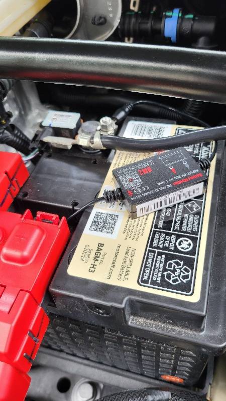

Any specific reason you went with the 6v-20v 1.5mA (Amazon has listed as for lithium batteries) vs the 8v-16v 1mA listed for “Modern” batteries?
Finally getting around to ordering one of these things.
Snakebitten
Mar 1, 2024
2,264
3,781
Coastal Texas
2023.5 Mach-E
Honestly, I have purchased them 4 times and never noticed the difference. I assumed a voltmeter was a voltmeter regardless of the battery chemistry. So really don't get the difference? ?
