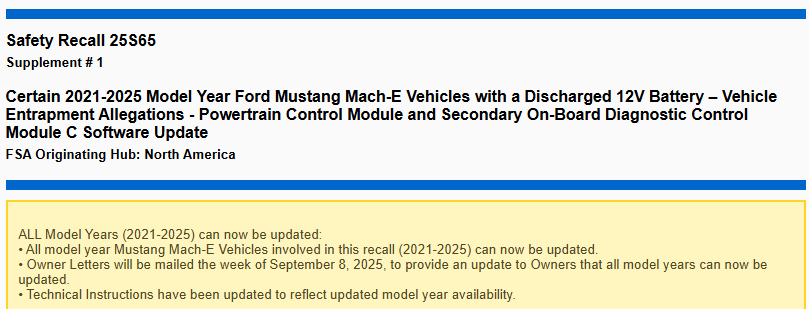

Happy to report that, as of this today, the software update is now available for 21-24MY. You can now proceed to work with your local Ford Dealer to schedule a time for them to perform the update on your vehicle.
At this time, I don’t have any news to share regarding the timing of this being released as an over-the-air update, but when I do I will share it here.
Mike G
Mar 27, 2022
6,450
5,289
N. AL, USA
Ford Mustang Mach-E 12V Recall (25S65) Software Released 25S65_Su
I had to look up the TSB again to find this supplement (and the enclosed bulletin). Please note this change has NOT been posted to PTS Alerts section (sort of the 'headlines section' of PTS) yet, so unless your service advisor is reading everything that comes along in their email, they may not be aware that this program has been green lit as of 5 Sep 25.
