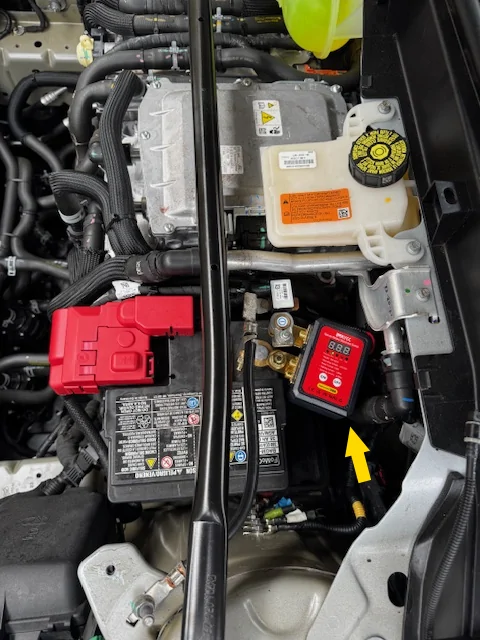

I have a 12V LVB disconnect switch installed. This was intended to facilitate the 'hard reboot' scenario where the car has gotten itself 'logic locked' (or just plain stupid) and needs to be completely powered down for a "time out" until it comes back to it's senses and will behave.
Ford Mustang Mach-E 12V Recall (25S65) Software Released MME_Battery_Cutoff2
So when I press the remote to kill the LVB it will now take up to 12 minutes (from whenever I shut the car off with the Start/Stop button) for the car's 12V systems to de-energize. It's just something I'll have to keep in mind.

You probably do not want to use that switch while the battery is being charged. Make sure the voltage is below 14V before using that switch or disconnecting a cable.

If the battery dies while the car is running around doing errands....and the DCDC converter is still providing power to the systems....does that harm anything?

I"m guessing not since the systems don't care where they're getting power from, just they are getting sufficient power. It's like when an ICE has a battery die while the engine is running. You don't really know when the battery died, just that you can't start it after shutting it off. Well, unless the power coming from the DC-DC converter is noisy/dirty (highly unlikely), which could cause signal corruption on comms lines. 🤷‍♂️🐩
