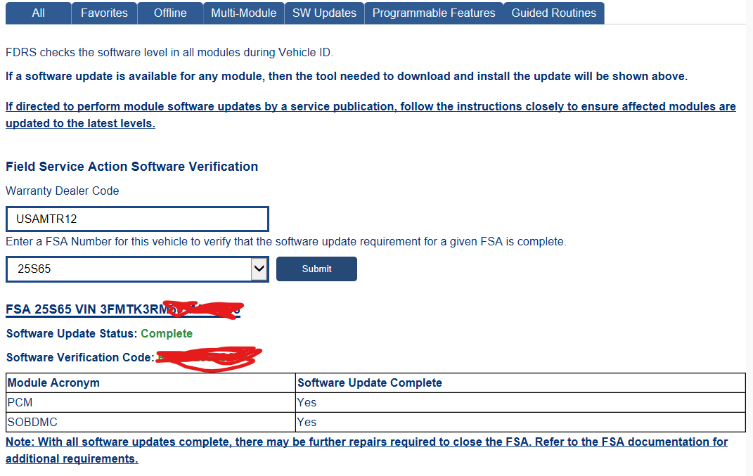

Only took 20 minutes to get this done with FDRS, and looks like we can mark recalls complete in FDRS now. It reported "Software Update Status: Complete" this time instead of throwing an error last recall update I did.
Ahhh, well done you!
I see all of us "Independent Operators" have the same Warranty Dealer Code (USAMTR12)

Yeah, would be nice if we could claim the hourly rate and get paid lol. Still shows as incomplete in my Ford Pass though. Maybe it syncs nightly or next business day. I'll check again tomorrow to see if it actually updated.

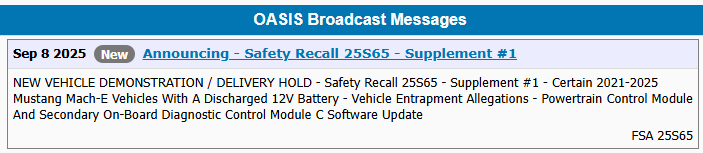

It went out as an OASIS broadcast message this morning. They're giving you outdated information.
Ford Mustang Mach-E 12V Recall (25S65) Software Released 1757348950984-f8
Clicking that link will take them to the updated one which says:
Ford Mustang Mach-E 12V Recall (25S65) Software Released 1757349036950-tu
