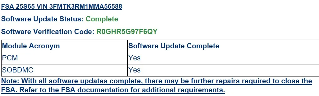

For anyone here with interest, I just updated my 2021 RWD MME PCM and SOBDMC modules using FDRS. I also had a BECM update waiting, so I completed that one, too. All, including setup and takedown of my FDRS equipment, took about 45 minutes with no drama.
Here are the changes for my MME:
  • PCM – MJ98-14C204-BSE to -BSG
  • SOBDMC – N98-14G069-MP to -MS
  • BECM - NJ98-14C197-AN to -AP
I also submitted the completion of Recall 25S65 through FDRS, and as reported by other members, it worked fine and gave me a "complete" result, as shown below:
