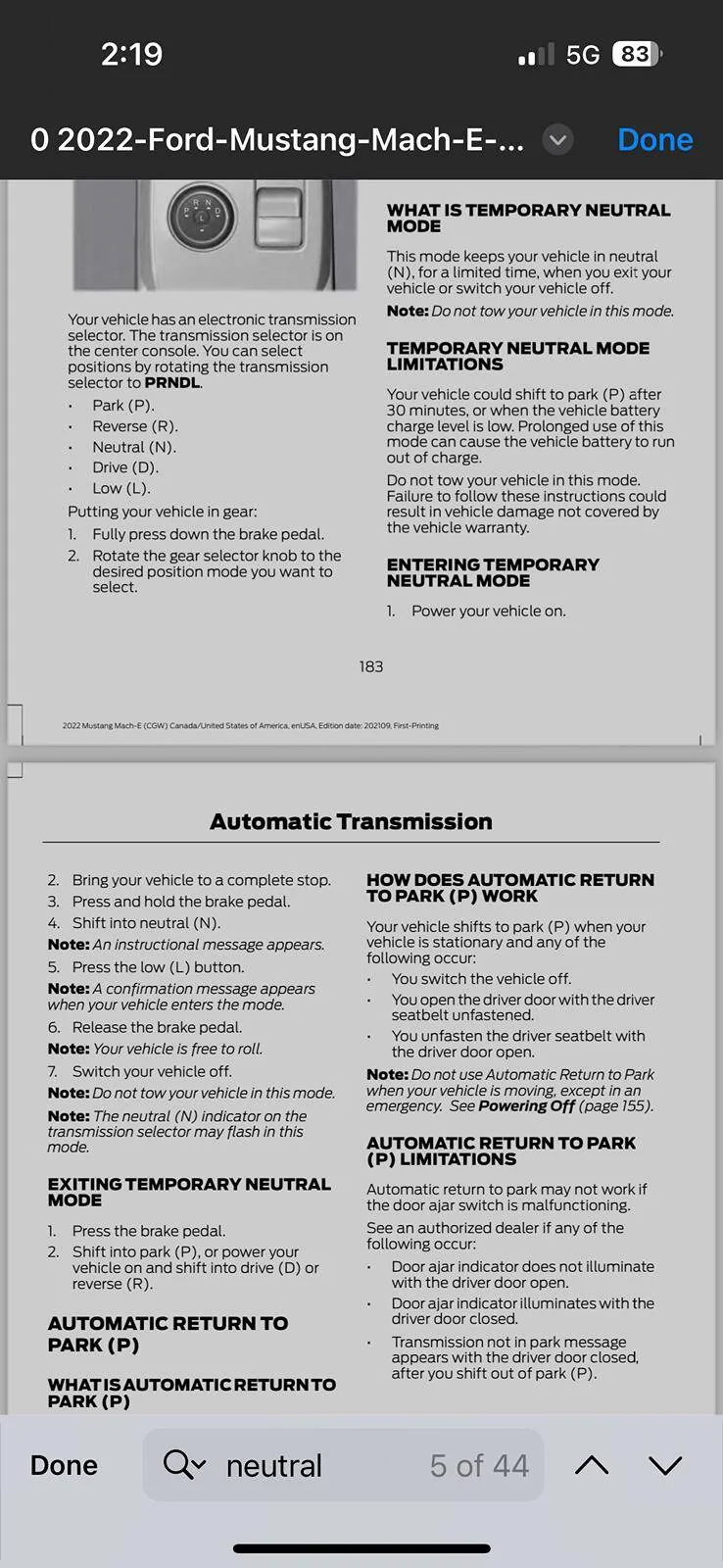

It could still be the 12v battery. There is a way to get the car into neutral if you can get the car started enough to be able to turn the shifter knob. If not, then you’ll need to get a tow truck with dollies.

Although I am only watching this thread, I wanted to compliment you for posting the pages from the owners manual. In a situation like this, posting the pages is really helpful so the OP doesn't have to search for the relevant pages when in an already stressful situation. Thanks from one member of the community.
