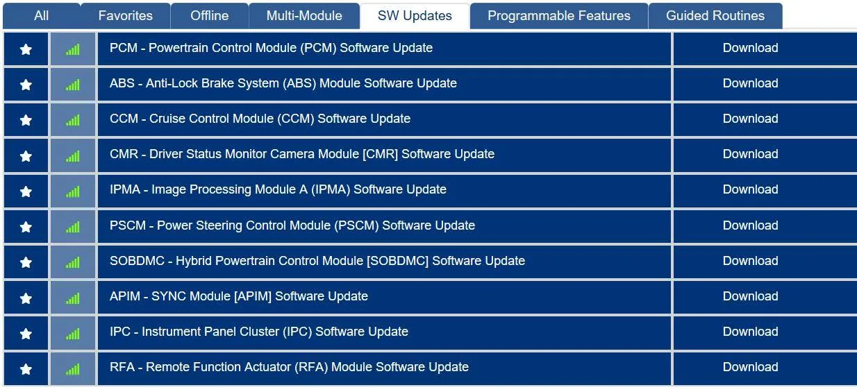

janfredrik

This is a screenshot I got from a member here a day after 21P22. They should have done more modules, right?

metalpro2021
For us Europeans to be able to get OTA-updates, all (or at least APIM) need to be updated by the dealer and this is NOT part of 21P22.... Some of us Dutchies (not me) have done FDRS updates ourselves > 2.x version in the car. Other people have gone to the dealer for windshield recall and the dealer did (the right) updates and 2.x was updated OTA. It is hit or miss at the moment...
