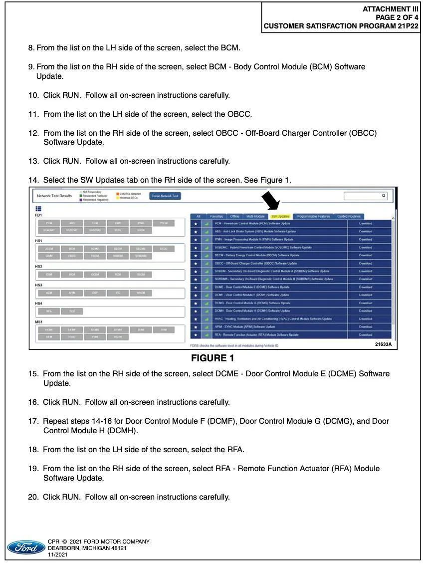

Bring in the instructions for the update. Make sure they do all 12 modules. Ask for proof that they did all 12. My dealership did the first 5 and said it was done. Thankfully a meme we on here checked for me and told me the screwed me. I then had to argue with the dealership to get them to finish the job.
Curious if these 3 pages are all the dealership needs? I'm trying to get mine to install it (2nd attempt - the first time they claimed to not know what a CSP was!) and I'd like to be able to hand them current, complete instructions to make sure they manage to get it done.
That should be all they need. It has all the steps and they have access to those instructions too. Maybe find another dealer?
