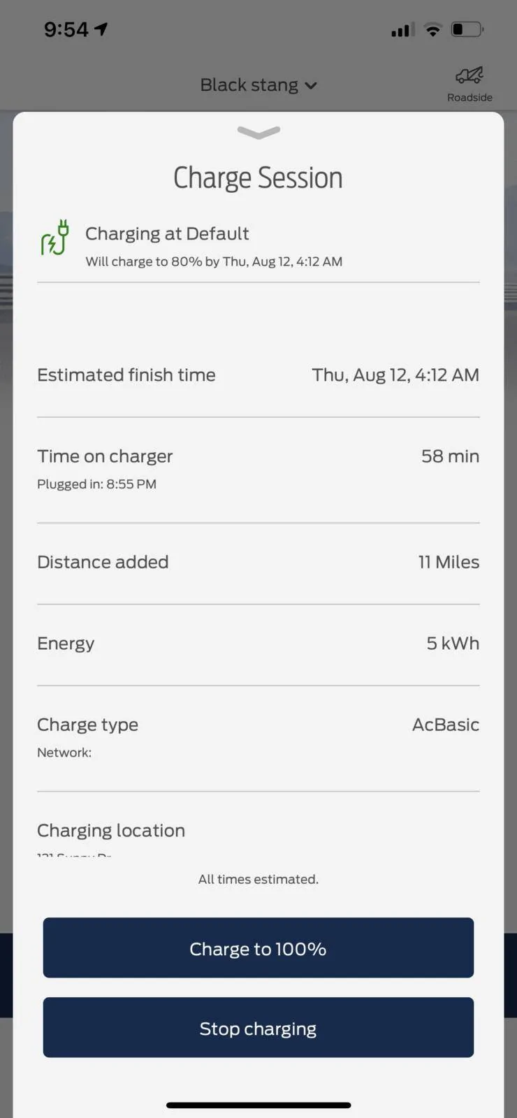

Ford mobile charger will draw 32 amps, 7.4 kw, and charge at about 20 MPH.
If the battery is too hot or cold, or if the 12V battery is low, it will correct those before actually charging. In your case, I'm guessing it spent 30 minutes cooling the battery before the charging started.

Huge thank you to everyone who responded to this thread! I won't worry too much about the charging or the car. I did just bring the car home after a 45 minute drive and plug it in, so as others have said the car was most likely cooling down the batteries.
Thank you everyone!!
