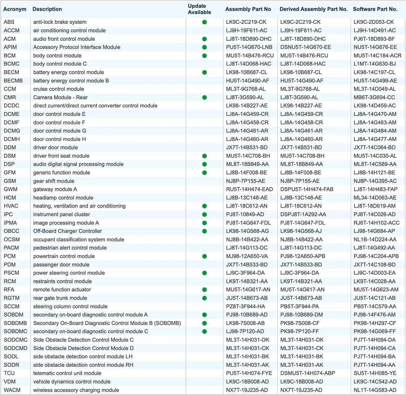

Some of the updates will occur via OTA. But Ford is slow to release OTAs so it could take a year. Dealers will not update your car for free unless there is an issue with something or a TSB/CSP specifying an update needs to be done. If you want your car fully updated, you will have to pay for labor at $200+/hr and it would typically take 6 hours or longer to update the whole car. Alternatively you can find a local FDRS updater to do updates for you or buy the equipment yourself for an estimated $750.
You can view your SYNC version in the "About SYNC" section on the touchscreen. You have a Job 2 2023 so you have BlueCruise 1.3 currently. Each module has its own software. Here are all your software versions:
Ford Mustang Mach-E A Guide to Understanding OTA Updates Screenshot 2024-07-14 at 10.14.23 AM
Yes there are module dependancies and things need to happen in a specific order for some series of updates. You got a GWM OTA, so the APIM v6.14 will probably be next.
Thank you so much! That was extremely helpful! The dealer route sounds painfully expensive. I guess if it bugs me enough, I just might go the local updater or learn to do it myself. Great suggestions and I really appreciate your help!
Ooh! Follow up question - how does the above screenshot and module updates relate to Sync version? Everyone seems to be talking about the newest version of Sync (6.14 ?). Thank you!
Scratch that. I think its starting to make some sense now.
