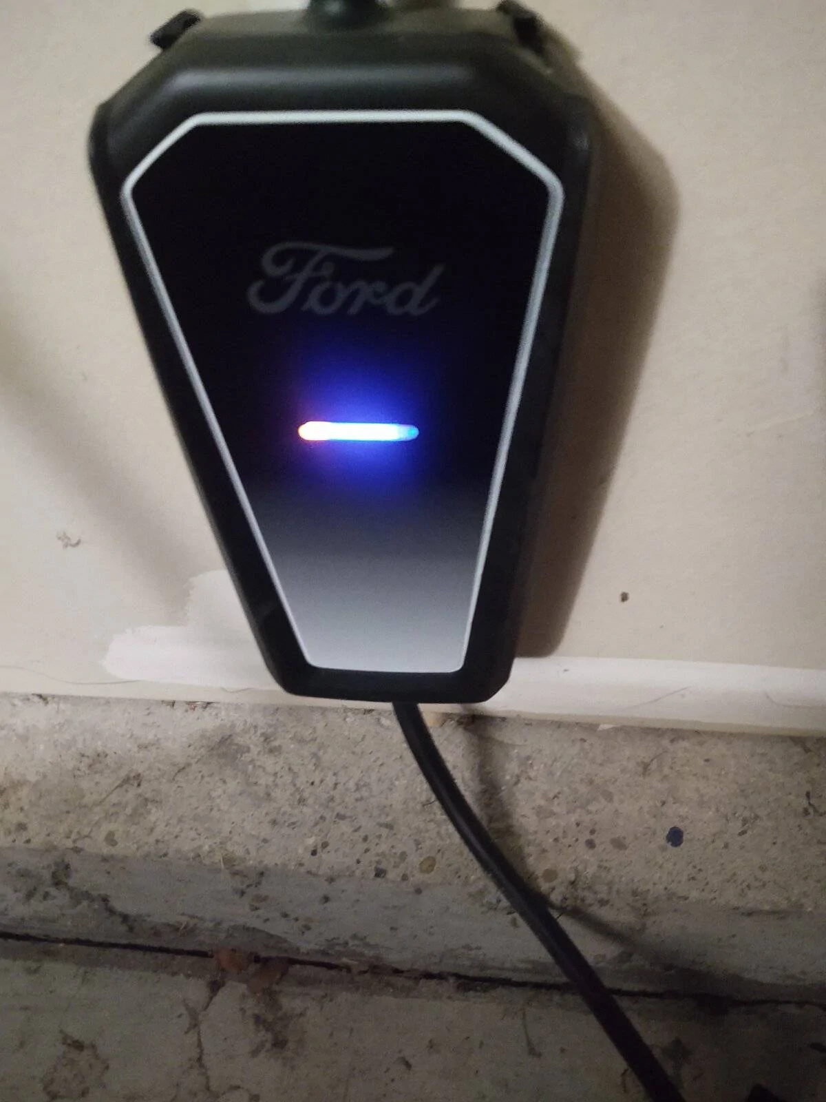

Another interesting tidbit... My charging speed was reduced all night and I woke up to 70% charge rather than my usual 90%. I saw there was a blue and amber light on the Ford charger. I'm still looking up what that means. Im assuming it means reduced charge speed due to the heat. Ford App said charge wouldn't be complete for another 24 hours when I woke up this morning.
Yes that's what it means. Charging slowed due to overheating in the EVSE. I was having the same thing happen so I switched over to the Connected Charge Station.
