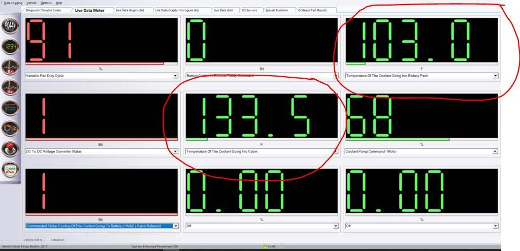

If the car is running then it should easily be able to manage the battery temps as long as the vehicle is driven sensibly. When I was driving my Focus Electric during temps like this.....if I mashed the pedal to the floor (to merge with traffic for instance), then the vehicle would divert more AC coolant to the battery chiller and much less to the passenger compartment. So, if we are delicate with the accelerator pedal then both the battery and the passengers should be comfortable. Here is a screen shot of the Focus Electric.
Temp of coolant going to the battery is 103. Temp of coolant going to the cabin is much higher. This probably because I was driving to aggressively at the time. :)
