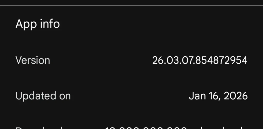

So, I will have to backtrack on this a little. Navigating this morning, I was back to the 0.0. I just checked my phone and same version of maps. It looks like you have a newer version of Maps.
I will also add that I navigated to a local charger (ChargePoint, about 5 miles away) and the 0.0 remained, and I did not get the plug icon, so I assume that the car will NOT precondition the battery. This is more important, IMO, due to it being winter especially. @Ford Motor Company Brian, can you give us an update - is this a Ford or Google issue? The lack of battery preconditioning is critical.
