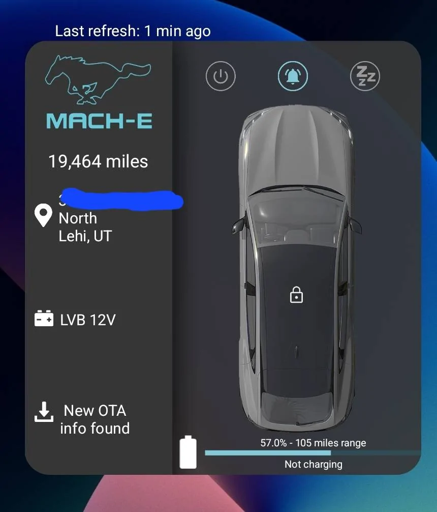

Works well on my Surface Duo 2 running Android 11.
One small thing is that the address can push the OTA status too far down - but the app's OTA status is sufficient. ?

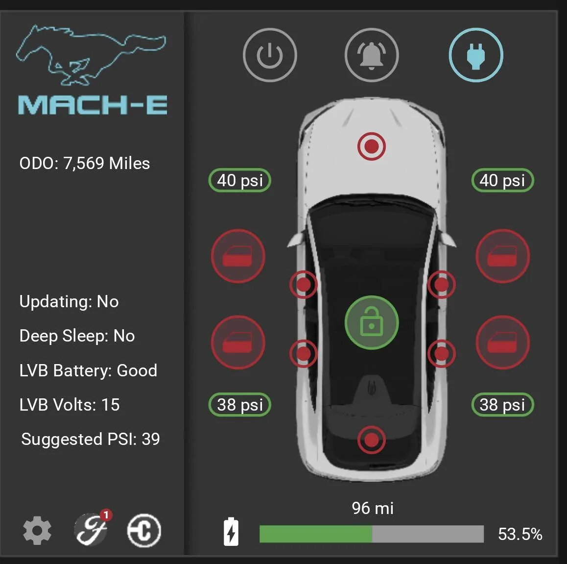

So... I found myself in a weird conundrum... I love the ease of use and functionality of the widget by @kennelh . But I love the design of the widget by @DevSecOps
So what did I do? I did what any ethical person would do and I stole both of their work shamelessly to make my own Frankenstein.
Ford Mustang Mach-E Android Widget for Mach-E [Less Complex] Screenshot_20220124-005515_One UI Hom
Maybe this is already in the works ???
Respectfully though, leave the UI design to me. You botched it up good ???
You know you could have just asked me for the assets, I'm here to help and anyone who wants to build upon it is welcome to.

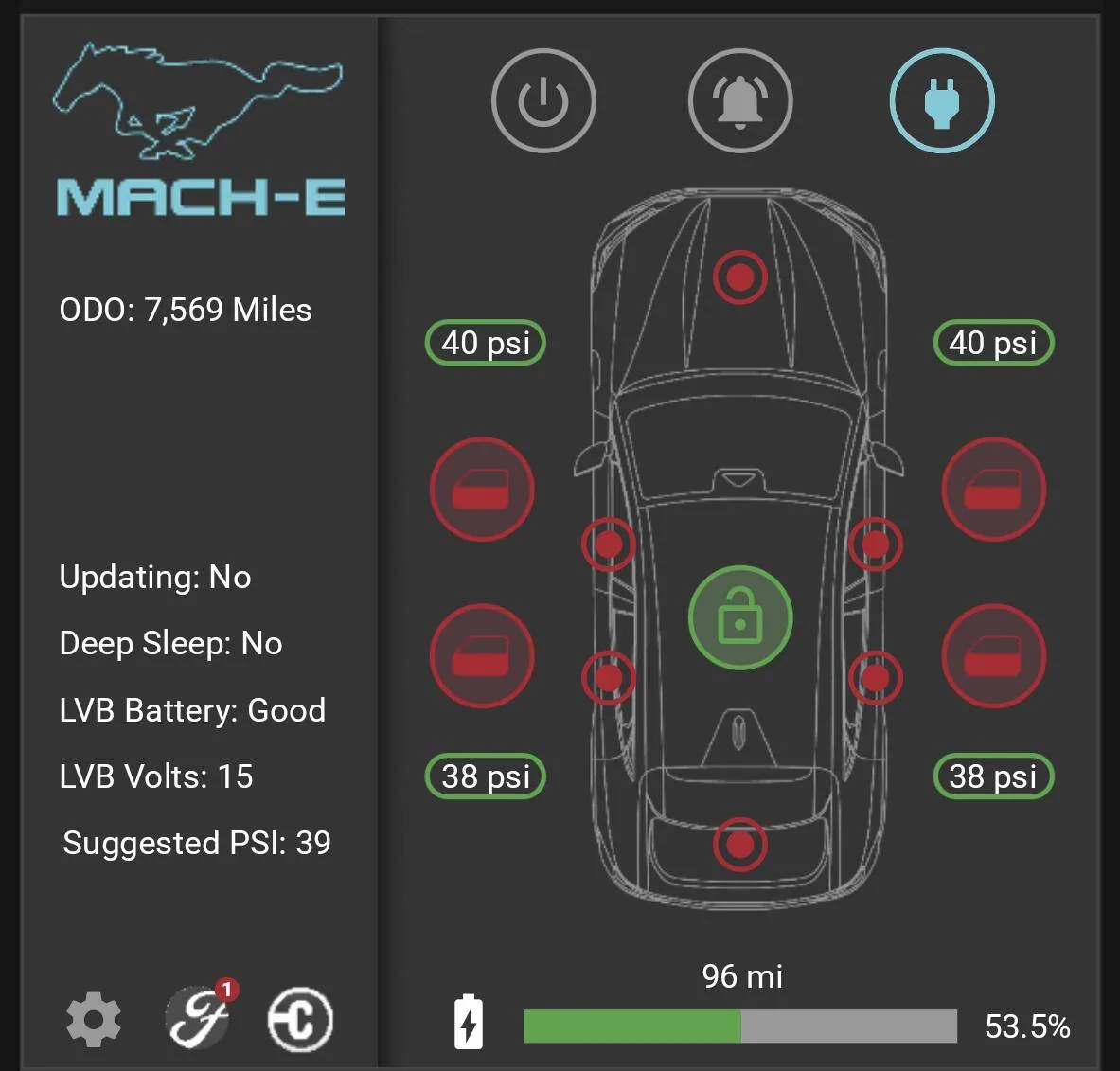

Here's all the alerts enabled so you can get a better view:
Ford Mustang Mach-E Android Widget for Mach-E [Less Complex] Screenshot_20220124-001003~2
Ford Mustang Mach-E Android Widget for Mach-E [Less Complex] Screenshot_20220124-001659~2

I didn't know how you implemented your door alerts.. I definitely took a different approach, but yours makes a lot of sense! Does it indicate windows as well?
The windows are the circles with the door icon furthest from the car. I need to change the icon to better represent a window. The dots are door open indicators. My thought was that people are probably more likely to leave windows open vs doors so I wanted to make the window alert more prominent.
I also have native Android notifications for doors open longer than 10 minutes but that doesn't make as much sense for Windows as some people like to leave them down. But it would be easy to make a simple if statement for vehicle off and window open and 10 minutes.

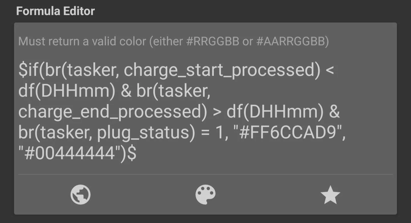

The door alerts are just visual layers that i trigger on and off based on the door open variable. Same with the lock icon and many others. I have a lot of simple formulas that visually control everything:
Ford Mustang Mach-E Android Widget for Mach-E [Less Complex] markup_27138
