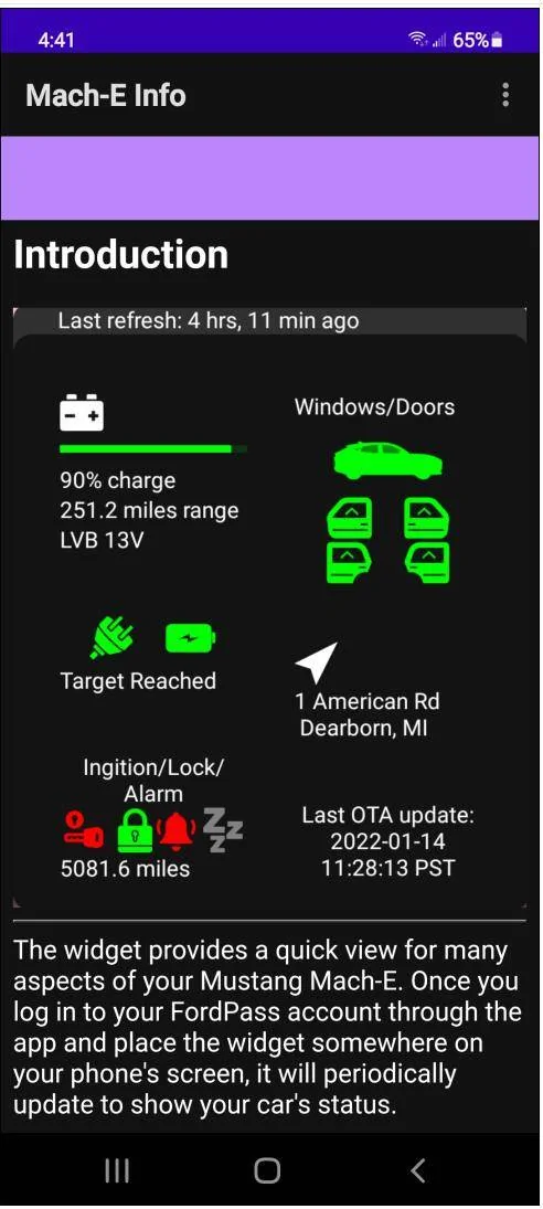

No luck for me :^(
Install went fine on my Samsung A52.
However, after Ford login (tried several times and use a password manager so I know login info is correct, just did a copy/paste), widget won't update. No errors, it is just stuck at what I assume is the stock initial screen? Thinks I'm in Dearborn Michigan and last refresh is stuck at 4 hours ago.
Range looks great though, as it is 14 degrees here in NJ... :^)

No luck for me :^(
The instructions have a screenshot of the widget; you actually have to install the widget on your phone's screen.

Oooh. Sorry - I'm not a phone guy - thought I could just open the app. Installed the widget and it works - just hope my car is in the driveway and not at the address it says - that one is about an eighth of a mile away...
