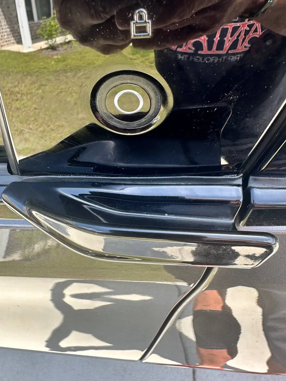

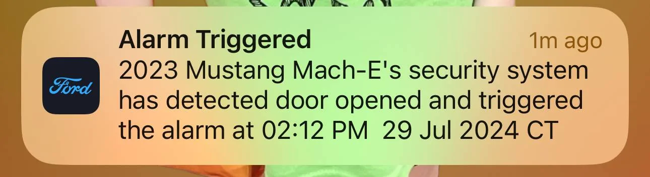

So I had some real thin nylon string laying around and I said let me go try this and I actually did it on my driver side, not the passenger side, I’m not sure if the passenger side operates different from the driver side, but man that thing open very easy I hardly had to pull on that string I believe only pulled one time. I had the keys far enough away and you could hear it starting to beep a little bit inside the car and then about 10 seconds later the horn started going off.

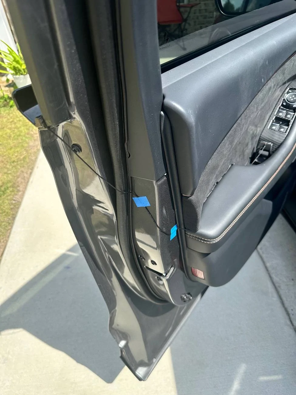

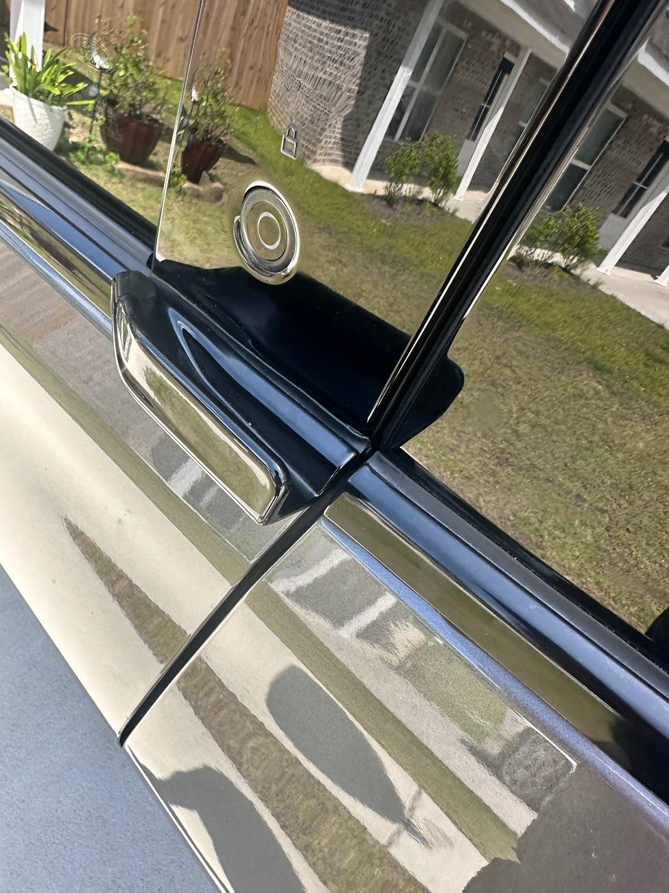

Well, in the meantime, just in case anything happens, I got my black nylon string today so I went to work with my scissors, my blue tape and my matches lol to get rid of the phrase and I think it’s hidden pretty well and it’s accessible by the doorhandle and the color of it in the way, I’ve got it in there. You can’t even see it, really looking Hard you might, but at night you’re not gonna notice it.

It’s only there until we know for sure this is not gonna happen but like I said the fact that you can’t see it is a plus, this is only assuming I have a good charge on my 12 V battery This is only being caused by something they recently put out there chances are it’ll be removed pretty soon, but just in case not that’s why I said it’s not obvious. I can come off in like one second better than standing on side of the road for an hour waiting for a tow truck.

Like I was saying you can’t see it now that I got this nylon black string and melted the ends. I almost couldn’t find it yesterday evening and the blue tape on the inside you only See if I open the door. Now, what do you need to be careful of you don’t want to use some super strong tape because then you may not be able to pull the string if the tape is too tough so you want painters tape like that blue but maybe a different color so it can break loose when you pull it
