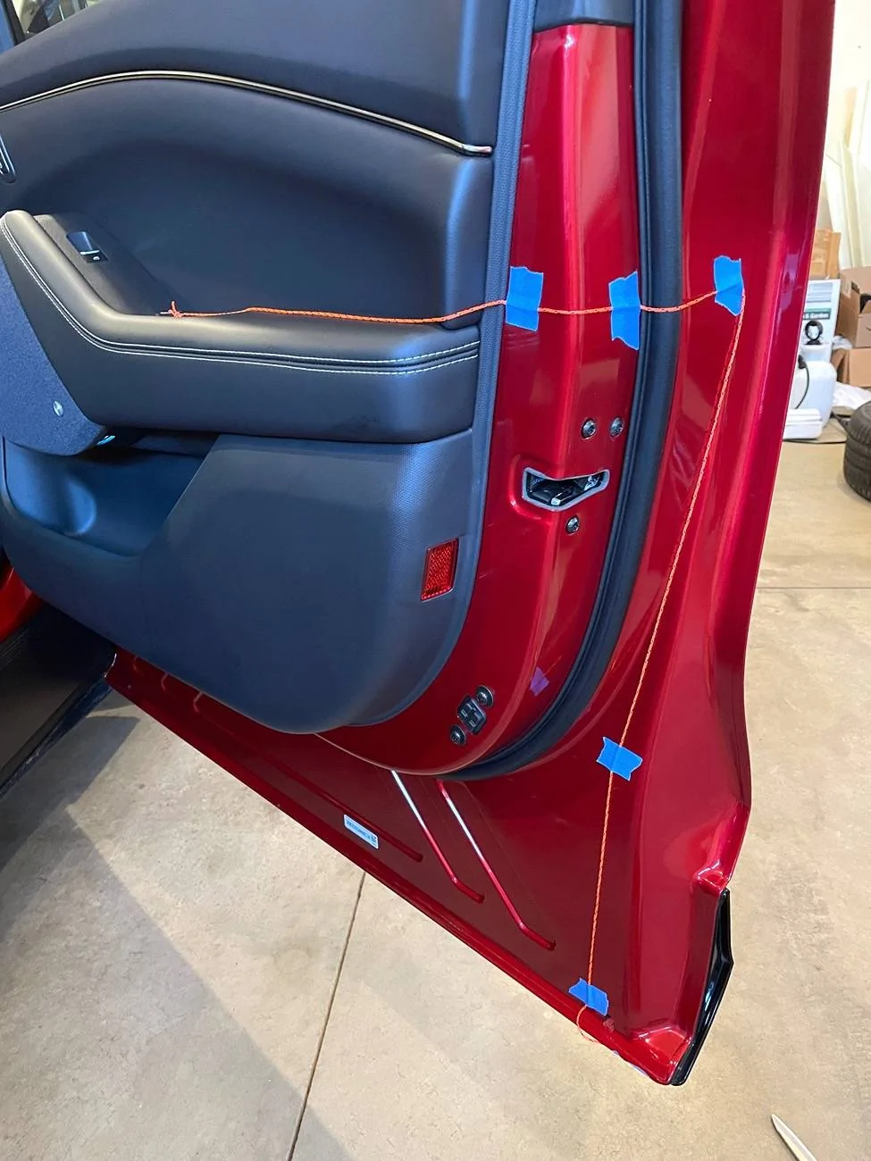

1. Tie the rope to the passenger front door handle as shown:
Ford Mustang Mach-E Anti-Lockout Solution for 2023-2024 Mach-E IMG_3158
2. Route the rope horizontally and down to the bottom of the door, using tape as shown.
Ford Mustang Mach-E Anti-Lockout Solution for 2023-2024 Mach-E IMG_3155

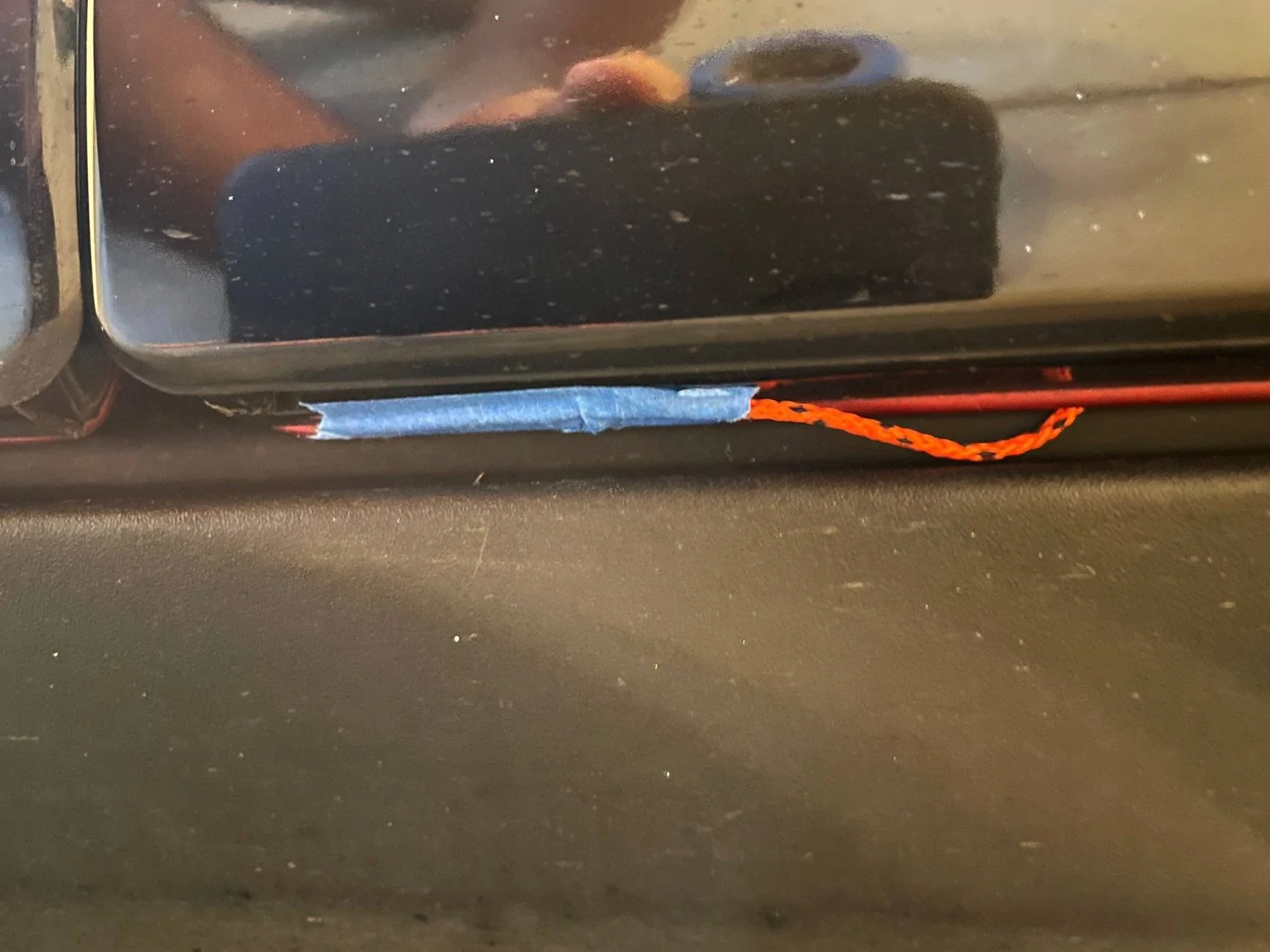

3. Cut the rope a couple inches longer than the bottom of the door, and tape the end of the rope to the bottom of the door:
Ford Mustang Mach-E Anti-Lockout Solution for 2023-2024 Mach-E IMG_3153
The rope cannot be seen outside of the car unless you are on hands and knees looking up at it. The only visible part would be on the armrest, I used orange rope for visibility, but you may want to choose black rope instead.

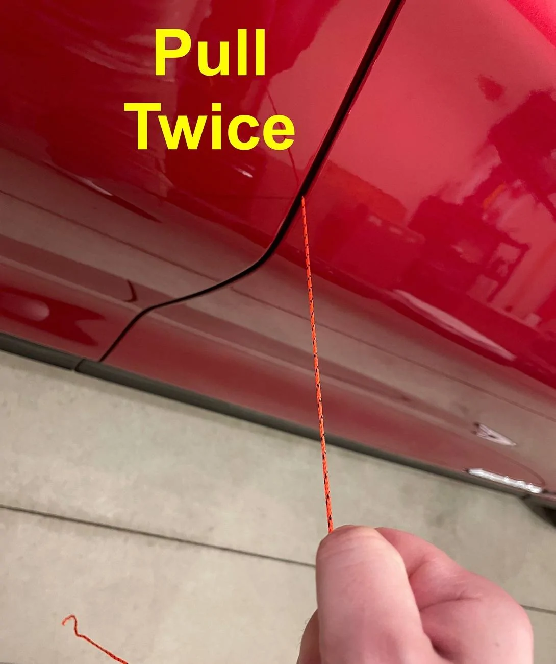

4. In the event of a lockout situation, detach the end of the rope under the door, and pull the string out from the slot between the front and rear doors (you will need to pull to rip the tape).
5. Once you have enough slack, hold the string slightly above the level of the door latch, and pull firmly. In my testing I had to pull the string twice to release the door.
Ford Mustang Mach-E Anti-Lockout Solution for 2023-2024 Mach-E IMG_3161
