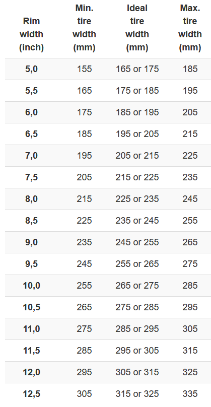

ok, Info I was able to get from the CA wheel site, for my AWD Select is:
2021 Ford Mustang Mach-E 4 Dr Sport Utility Select + change vehicle
Size Bolt Offset bore OE Tire L/S Type Thread Hex TPM
18x7.5 5x108 38-53 mm 63.4 225/60R18 104/H nut M12x1.5 19 Yes
stock tires 225/60R18
....I am wondering if anyone has actually measured and verified these numbers for fitment? I am particularly concerned with the 5x108 bolt pattern as this severely limits choices...
once we know for SURE, then I'd be very interested in seeing a list of available wheels, and sources for after-market. I usually shop hard for lightest wheels, but at 'reasonable' price being something less than $300/wheel.
