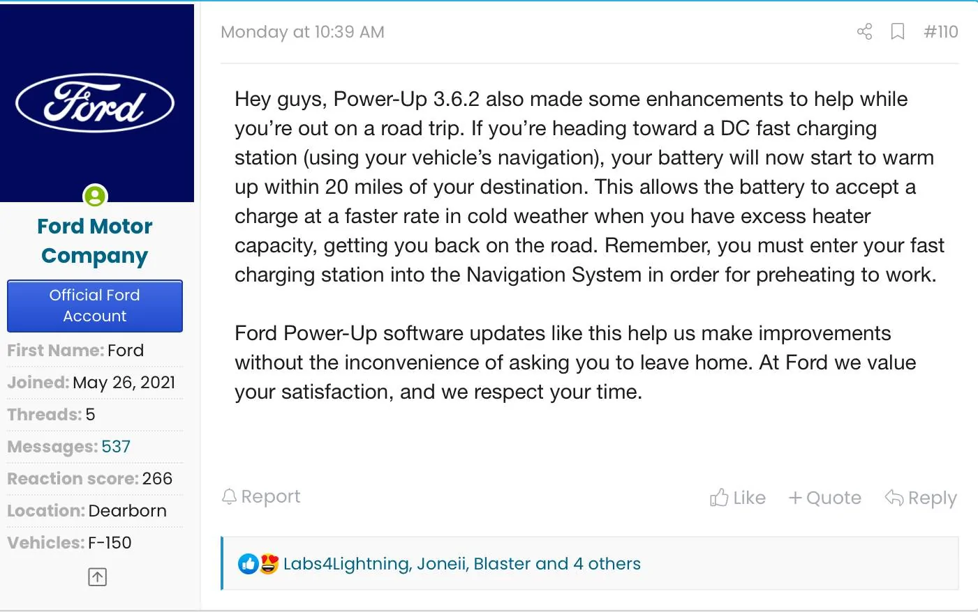

3.6.2, if memory serves.
Edit:
Confirmed
I do not remember this update. I have a 22 rwd select that I have had since may 22. I am on 4.2.4 and this does not appear to be the case for me otherwise I’d have better charging sessions, especially on a few cross country trips I have taken

The built-in nav however does do this if you use that nav (and only that nav, no others do it) to route you to a DCFC location. I've not tried it myself, but that's what's been written up in multiple threads on this forum.
Hmm, makes me wonder if I've been shooting myself in the foot with my "regular" road trip fast chargers. I've found a few I like on a route that I do a few times a year and just enter the address to the Walmart (or whatever) where the station is as my destination, rather than entering my actual final destination and letting it add chargers. So the nav system might assume that I'm going to fast charge when I reach each destination, but I don't usually tell it that explicitly. I guess if nobody knows, I'll have to figure out ODB and test it myself.
