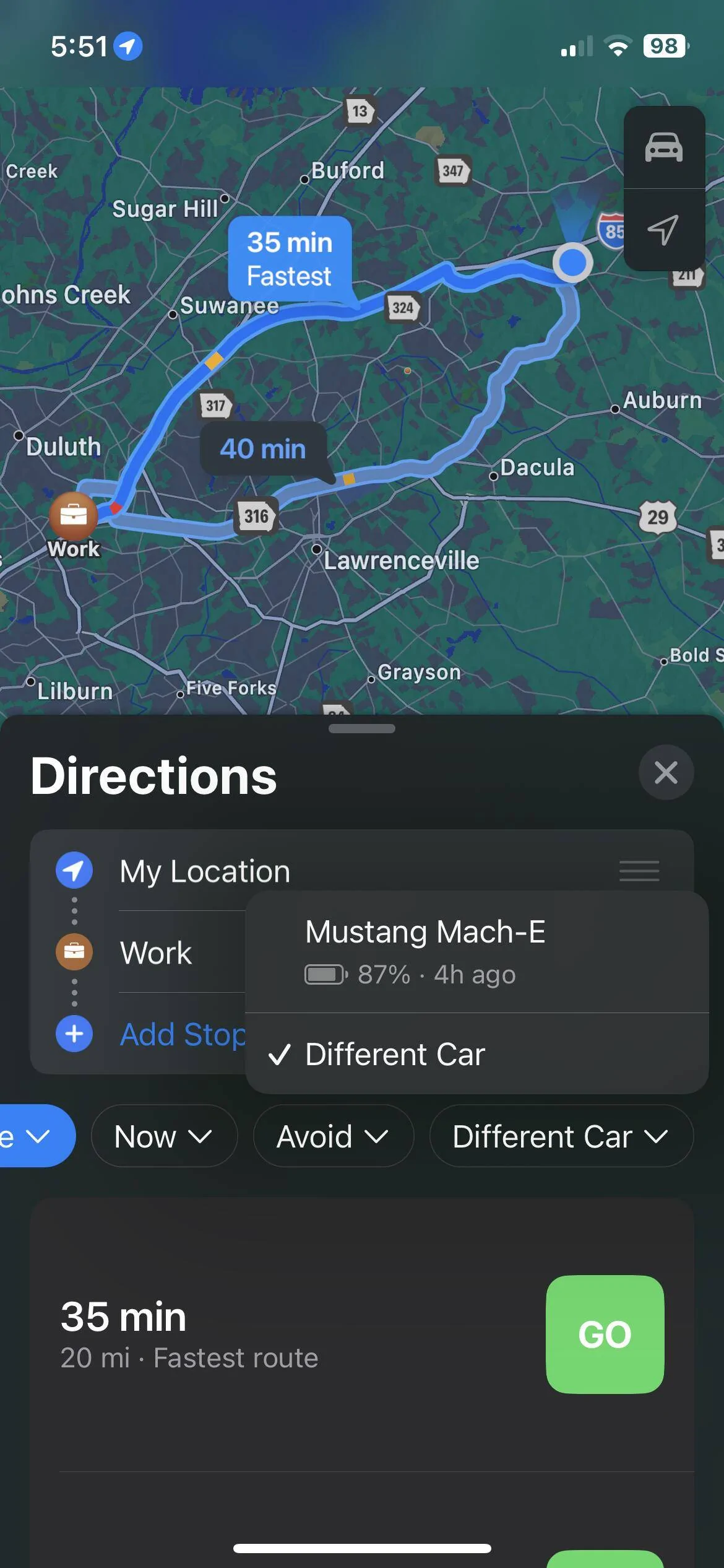

I don't think you can change what is displayed from CarPlay.
From the phone when planning a trip you can toggle between cars or different car. If your car is selected, CarPlay will show %. If Different Car is selected you will get time and miles.
Ford Mustang Mach-E Apple Maps - data fields IMG_3800
