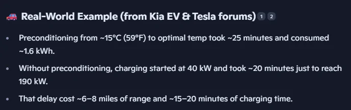

But that’s 30 minutes using your car battery while you’re also using your car battery to drive your car. I gotta believe that a high power DCFC will heat the battery a little (or a lot) quicker.
It won't because the battery management won't let that happen, not to mention if it did it would be bad for the battery.
When thinking about this one has to understand why there is charge curve in the first place.
Yes, there is an underline battery "driving it", but it is more complicated than just "push as much power in as you can".
The battery management system is controlling that charge curve. It is monitoring different things like the battery temperature and regulating the amount of power based on the information it has.
In the case of the battery being outside of the range for charging, it will first draw power to get the battery into that range by heating or cooling it, before it will send power to the battery.
The battery has a lot of mass that has to be heated/cooled, and the heater/air condition has its limits. Not to mention it is better heat/cool things slowly as not to cause a shock to the system.
So, there isn't any "DCFC heating" (or not very much) going on to get the battery up to the right temperature.
Ford Mustang Mach-E Apple Maps Preconditioning 1759772454447-1u
