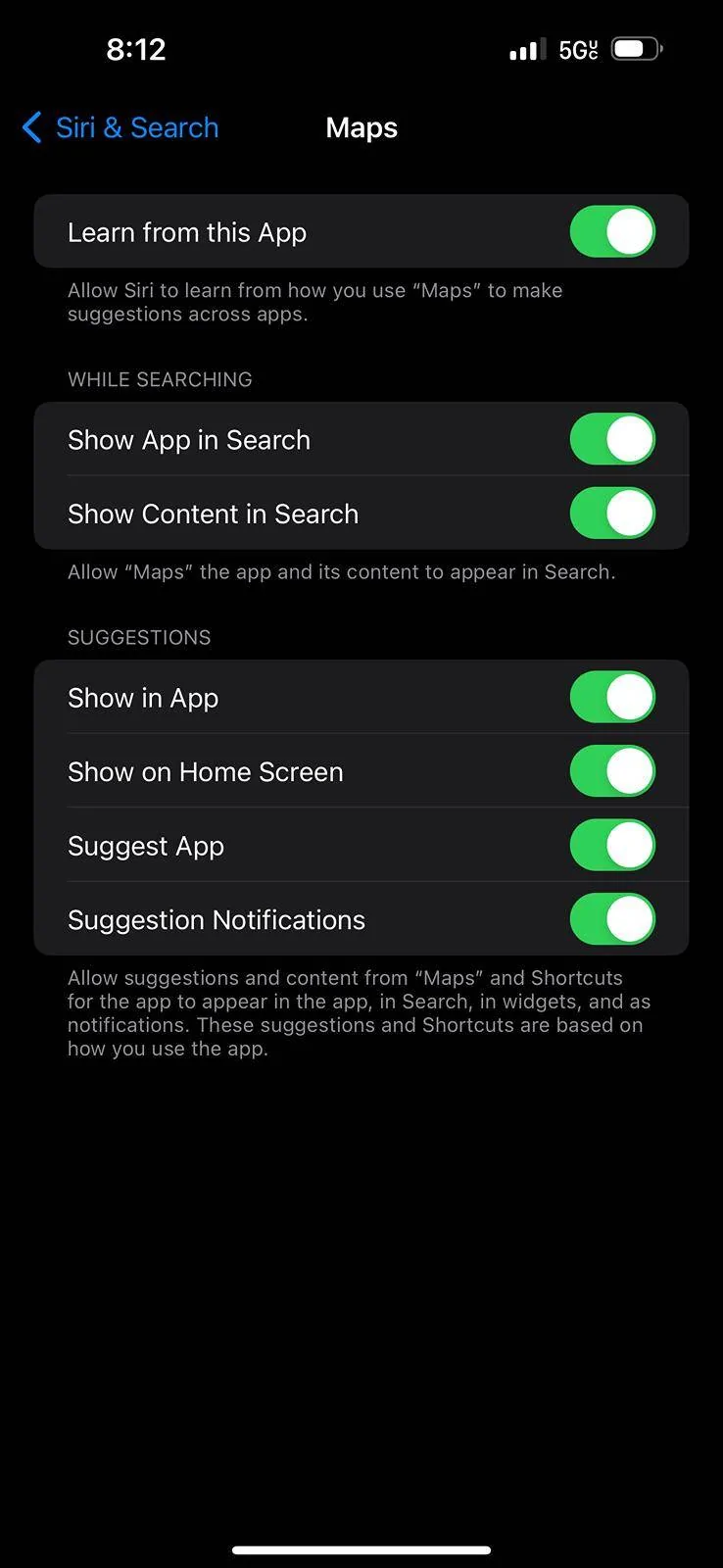

For Apple Maps, you need to disable Siri suggestions in Settings, Maps, Siri & Search. You may want to give Apple Maps a try as it integrates with the Mach-E, giving you destination SOC and upcoming turns in the instrument cluster.

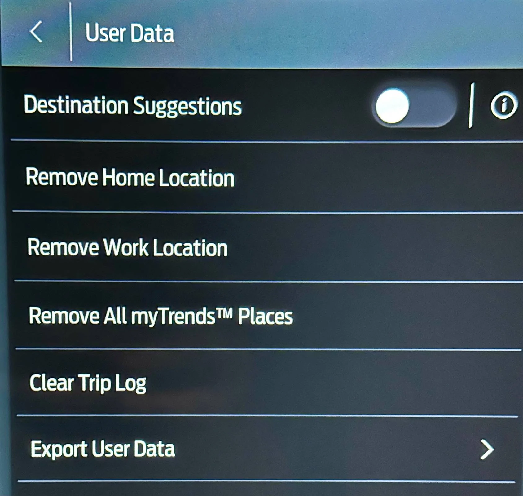

In Ford Navigation, the setting is under the tools icon, Settings, User Data, Destination Suggestions

That sounds like the built in nav.
Open the navigation app in the car and go to its settings, user data, and disable the predictive destination, or whatever it’s called.
