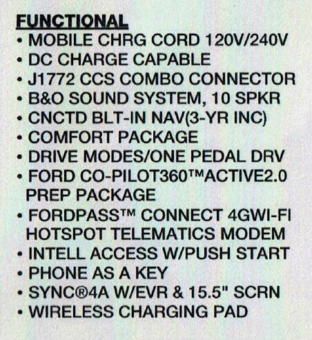

Mine looks like this:
No mention of 10.5 KW OnBoard Charger or Up to 150KW DC Chrg Capabl
Yeah I think its because my CA Rt1 has less features than a First Edition or a Premium they filled in that section with "other" stuff to make it look good instead of a blank spot LOL.

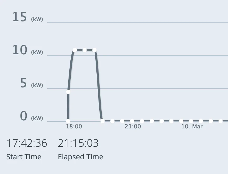

I have a charge point on a 60amp circuit, so it delivers 48amp to the car. Chargepoint reports that my car pulls a constant 11kw while charging.

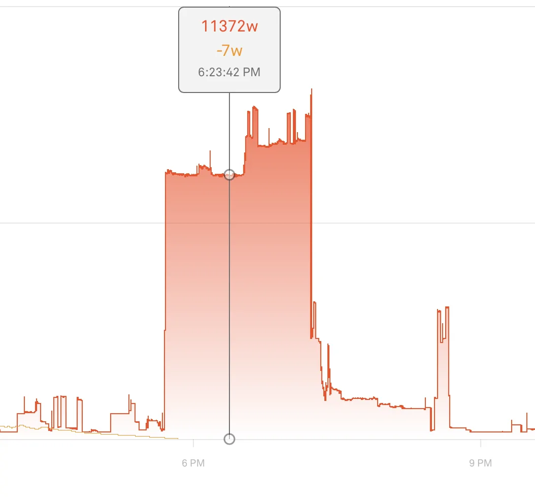

11 kW works fine, also a chargepoint Flex. More detail with the sense energy monitor, but that is whole panel, so includes bumps from other stuff running in the home.
