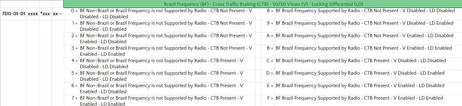

In that case, try these APIM settings to get 50/50 views to show. Change whatever you have here to keep everything the same but enable "V":

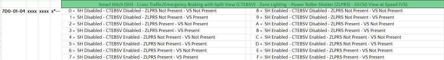

And do the same here to keep everything as is bit enable VS:

If it doesn't work, just change it back to whatever was there before.
