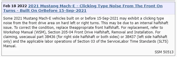

Took mine in for the “clunking” noise and the tech said it was subtle and not a foreseeable issue. I don’t get why they think this is normal for a $60K car

They don't know about the SSM. Provide this and they might realize their mistake. Which is - don't question a MME Forum member.
I did provide the SSM. The advisor even wrote it on the labor sheet. Both the technician and the service advisor drove the car and “barely noticed” the sound and advised it wasn’t audible enough to be an issue and to reassess in a month or two. I’m bummed
Try another dealer?
