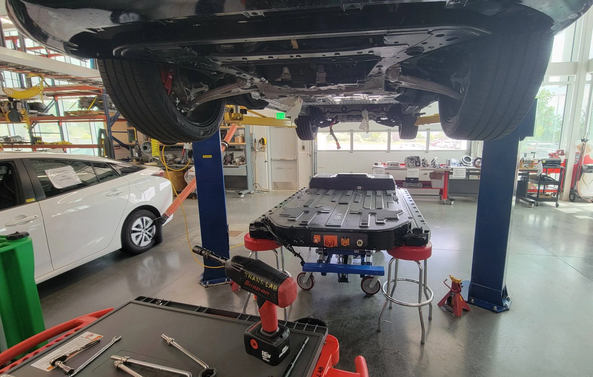

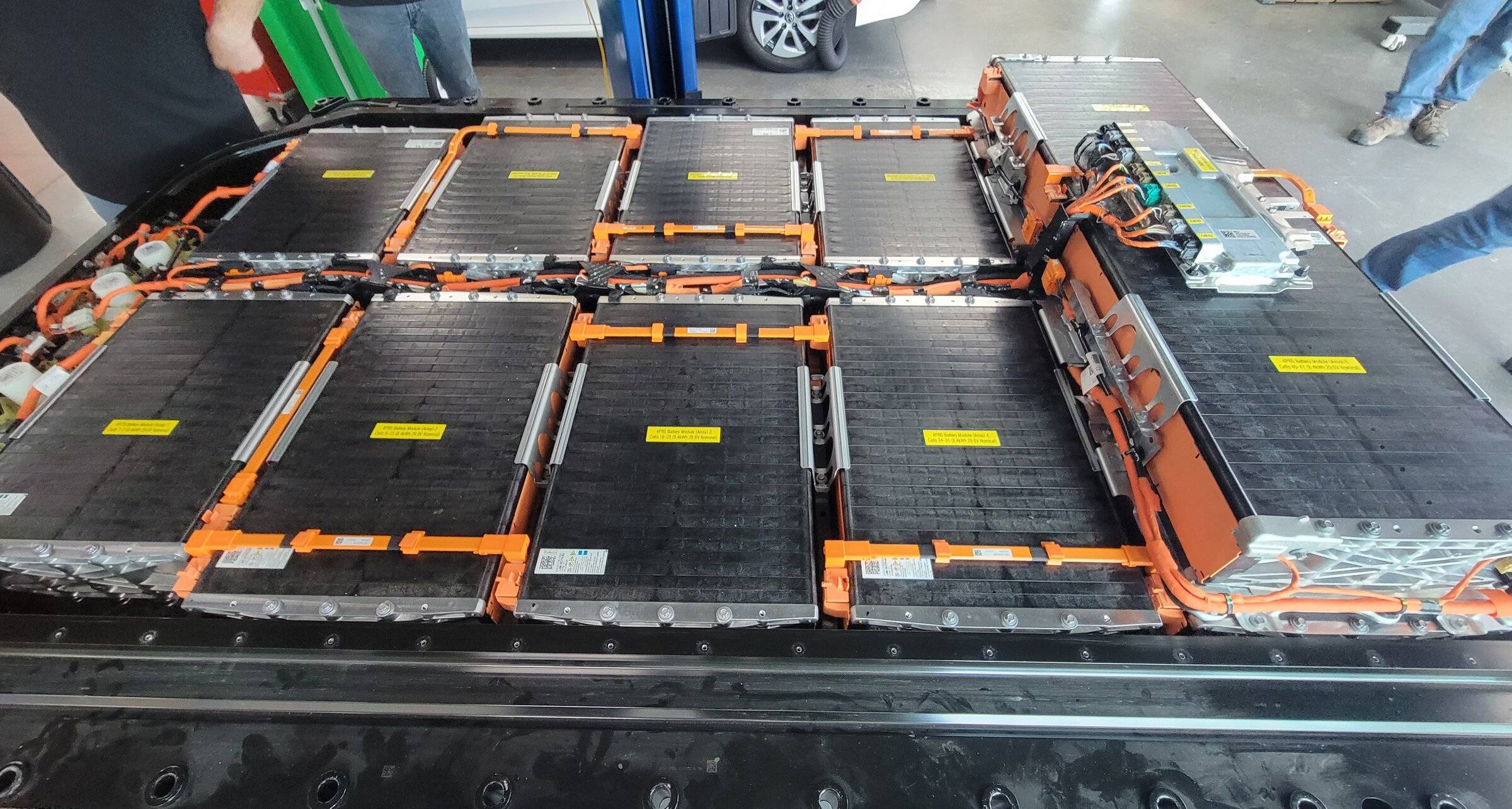

EV trained service technicians are equipped to replace modules (but not individual cells within a module). They won't replace the entire pack unless that's actually necessary.
Likewise, non-EV trained techs won't even unbolt or lower the pack from the vehicle.
Here's a cool video showing how modules are arranged into a pack on a similar BEV to ours.
