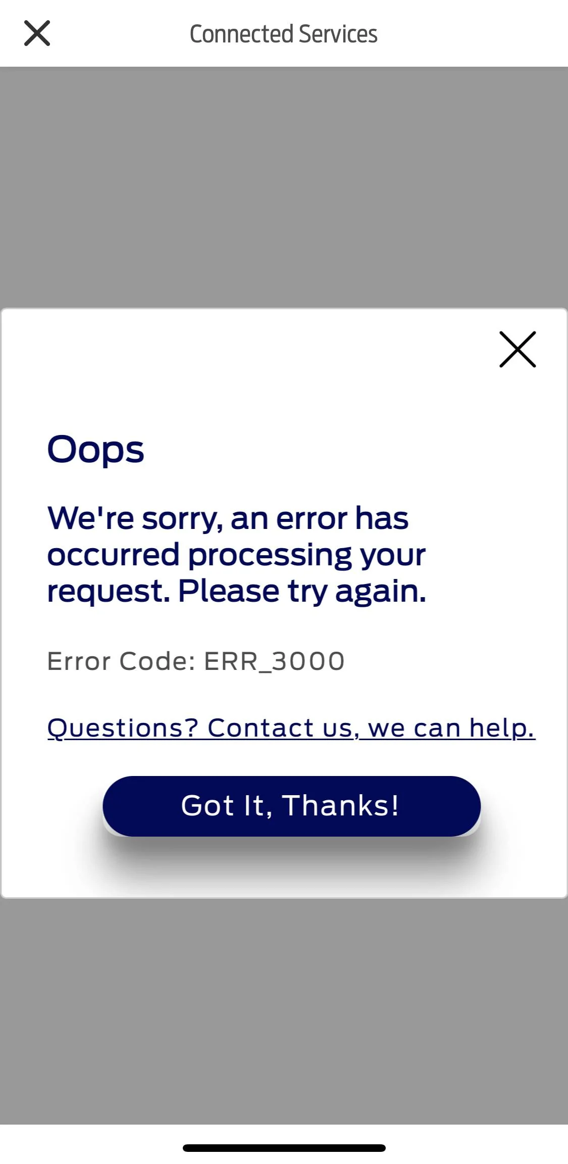

2.8.2 installed yesterday and when I tried to Activate Blue Cruise kept running into ERR_3000:
Ford Mustang Mach-E BlueCruise going out OTA to regular plebs (non-EA owners)! E6EB56F2-1B63-4513-981A-B2149071B712
Has anyone else experienced something similar? The only reference I can find in the forum is on another thread with regards to activating the Blue Oval Charging Network and adding a CC to the User Account.
Seems like a Serve-side issue when I try to Activate? @Ford Motor Company

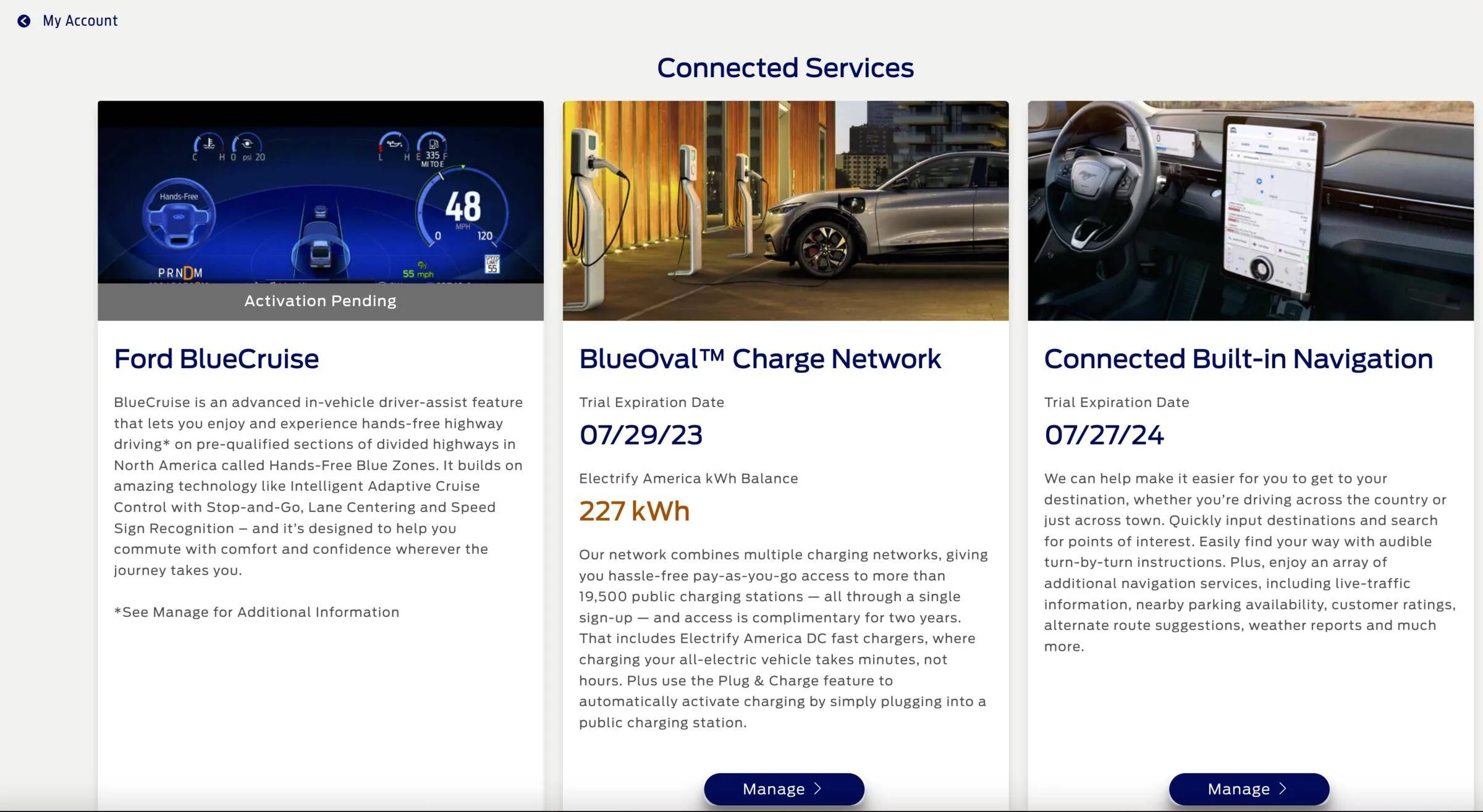

Updates applied at the dealership in May. I checked today and have "Activation Pending" in connected services but no way to actually turn on BlueCruise in either owner.ford.com or FordPass. There is no Manage button like for other services. On Chat right now with Ford agent.
Ford Mustang Mach-E BlueCruise going out OTA to regular plebs (non-EA owners)! Screen Shot 2022-06-01 at 10.36.38 AM
