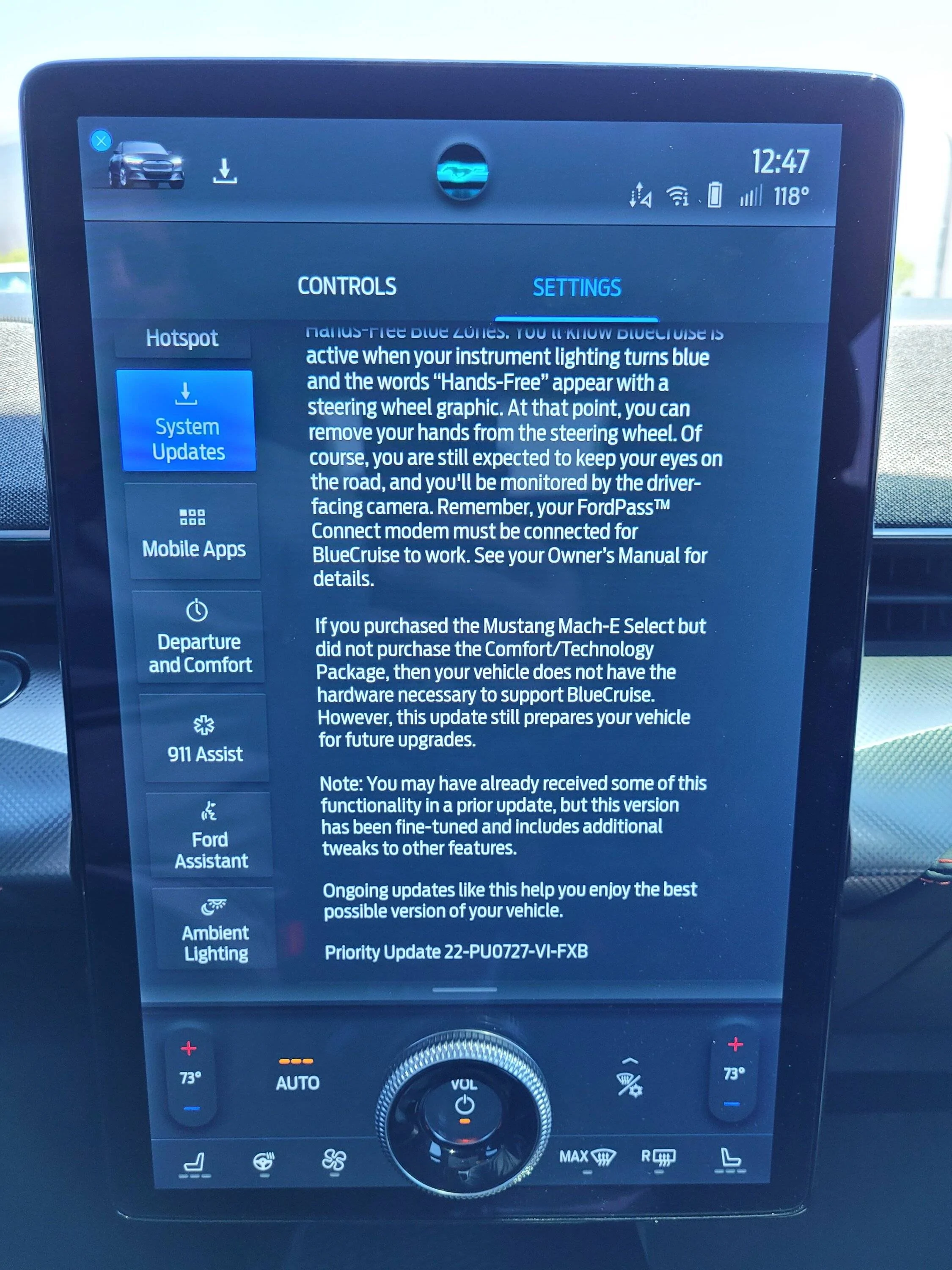

Received a message today for another Power Up. The notes said something about improving Blue Cruise Hands Free so I accepted the update.
Next step is for the car to download the package. If it requires scheduled downtime then I will get to pick a time that is convenient for me. If not, then it will install itself and let me know when completed.
I will be interested to see if this improves the steering performance any. (Crossing fingers.. )

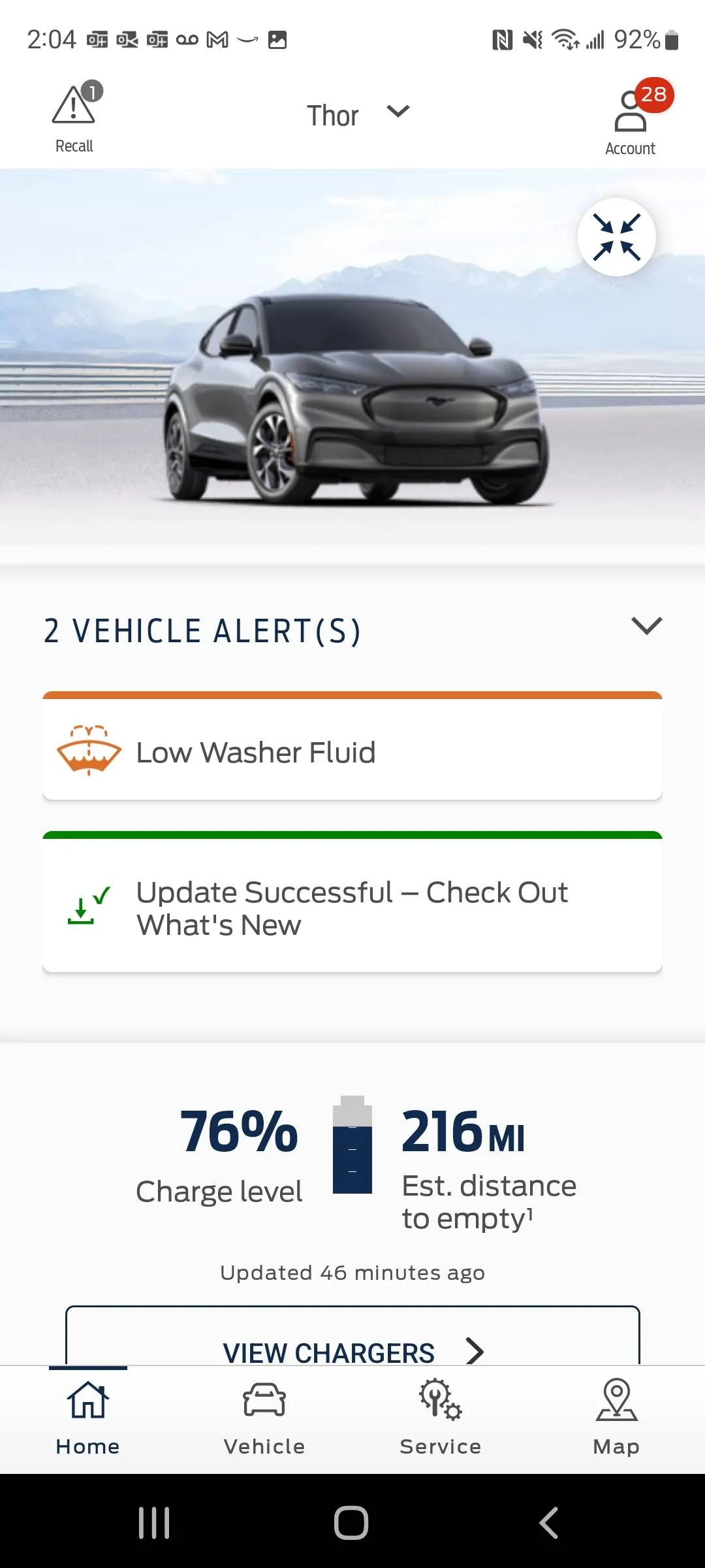

That was fast. Will see if it drives any different.
On a side note.....
The car really does NOT like being low on washer fluid. I have seen several dozen alerts so far. :)

However, I am happy to report this is a very worthwhile update. Almost all the symptoms appear to be addressed. The update installed while I stopped for lunch and then I headed out to a jobsite immediately after which was about a 45 mile round trip on BC routes.
BlueCruise functioned 100%. The only time it dropped down to BCHO were in expected areas such as large sweeping curves, interchanges, off ramps etc. There were no micro adjustment nor did it hunt for the right side of the lane. Lane control was extremely smooth. In fact, there were a few times that I completely forgot it was driving itself. The wheel was smooth and steady.
At no time did BC drop completely like I am used to experiencing.
When I changed lanes, BCHF resumed immediately and gently found the center of the lane without hunting around.
There were no Front Camera Faults and no Pre-Collision Assist Unavailable messages (although it is much too soon to declare those symptoms have been fixed).
This is the first meaningful update that I have received in 18 months of ownership.
Ford did very well with this one! ?
