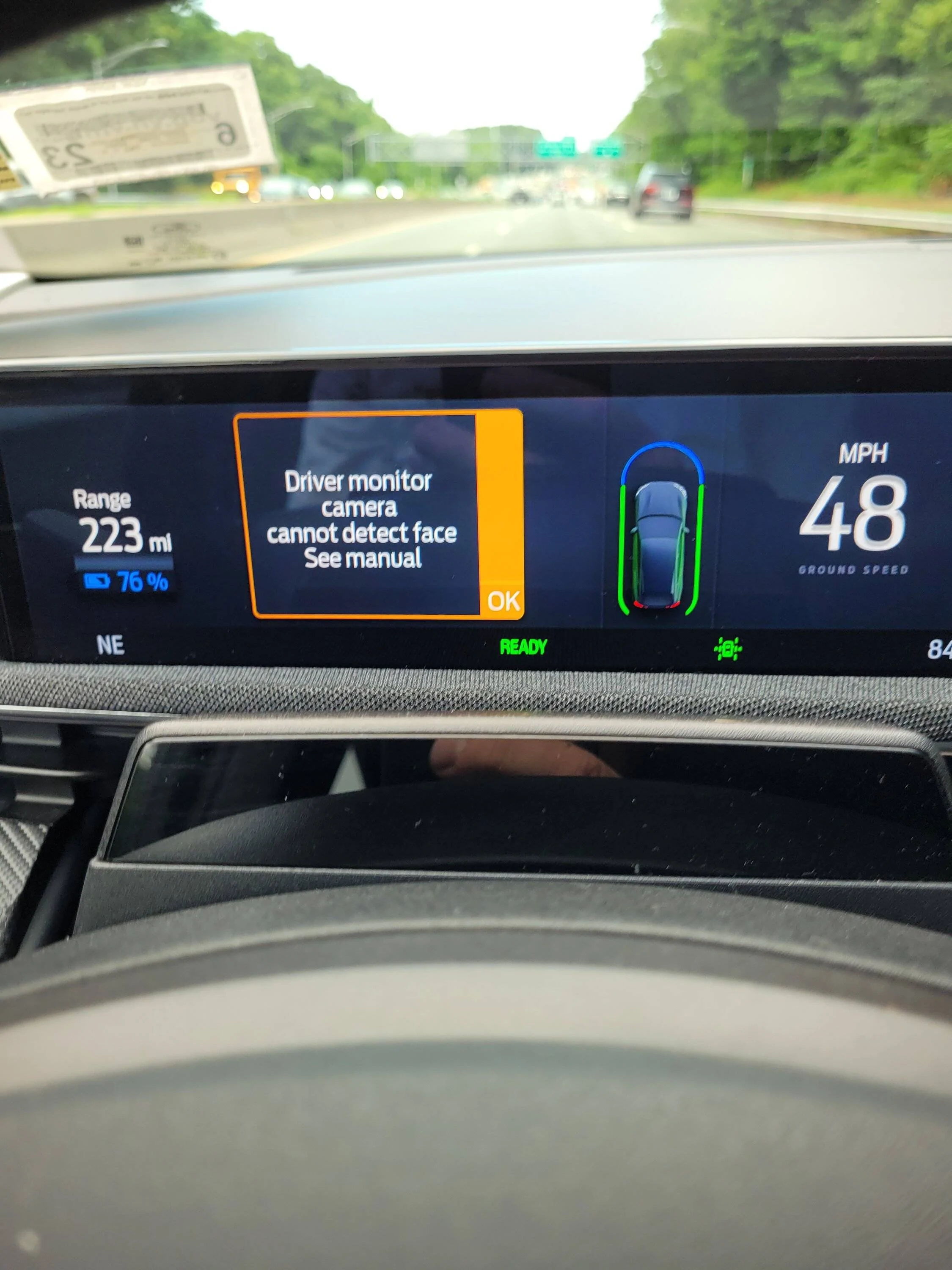

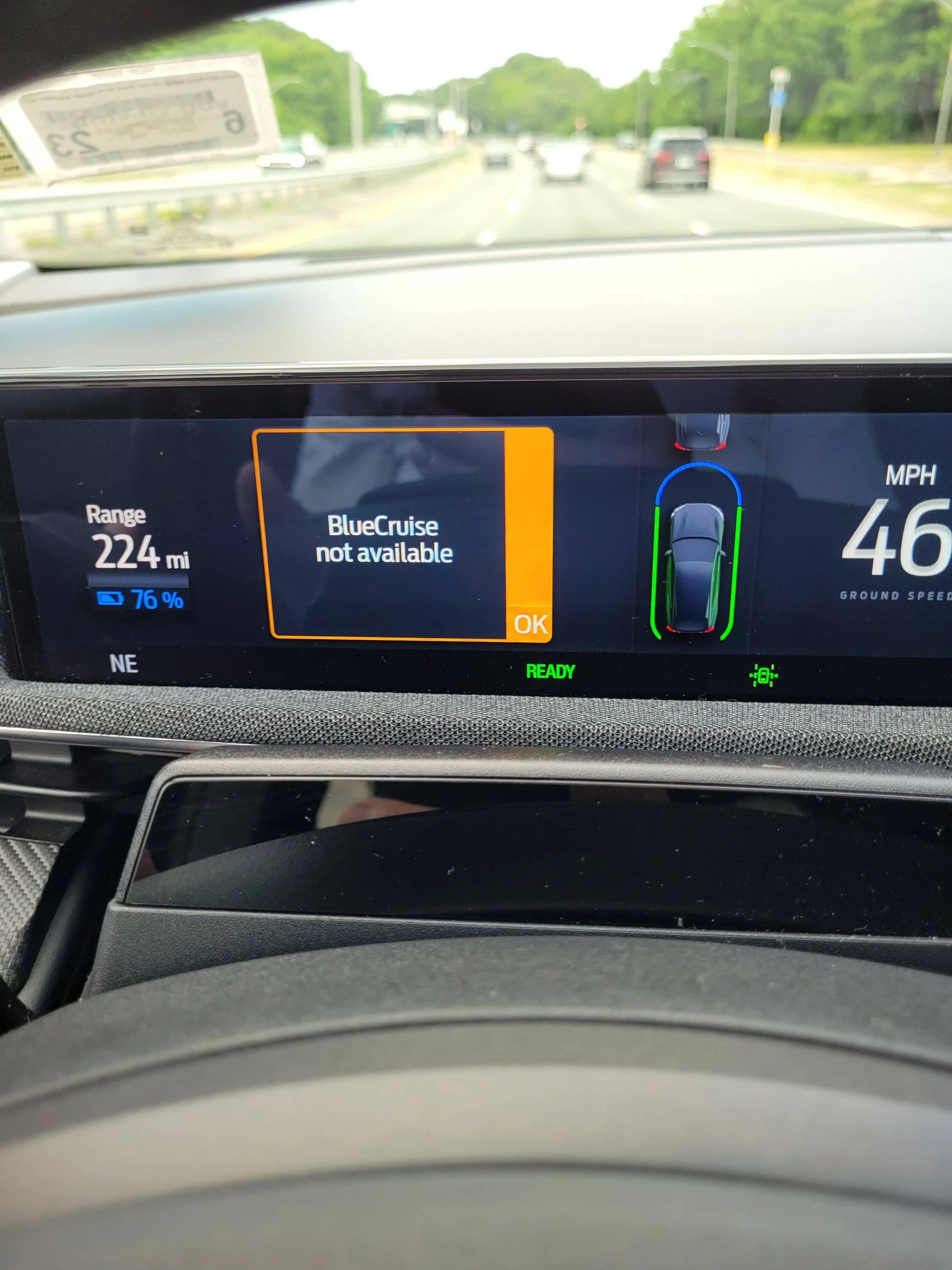

I have a job 1 and recently had the windshield, roof recall completed along with 22S41 and 21G01 performed. Anytime I engage cruise control with lane keeping I get the attached message on the IP screen. The second image appears when I took a picture of the message so it seems the face recognition is working. The third image is of the settings screen. Anyone give me advise what needs to be done ?

Based on your Sync display, it appears your vehicle is not up to date with BlueCruise software, it should have an option for Hands Free Lane Centering.
Did BlueCruise ever work on your car?
You need to go back to the dealer to have them fix it.

Never had any indication of Blue Cruise before the 21G01 was applied by the dealer, so no never had Blue Cruise

Dealer failed to update your car properly. Last step of update clearly says to take the car on a BlueCruise road and drive it with BlueCruise. Take it back and be annoyed with them.

You do not have bluecruise!!!! Take it back immediately

I figured that was the issue. I have called the Ford Lincoln of Queens on 7/19 and 7/22 and left voice mails and have not received a call back. Sent email today. I feel they are avoiding speaking to me. Not shocked by this. Thank you for your replies.
I checked your VIN for the install history:
1. They did not install the 22S41 recall updates
2. All of the Blue Cruise updates are installed. The SYNC handsfree options come up after they do one or two SYNC resets. I'm not sure if the FDRS reset and steering controls reset (hold volume down and right arrow/next track) do the same thing or not but you could give it a try. Do two steering control resets and see if you get a handsfree option in your adaptive cruise setting.
