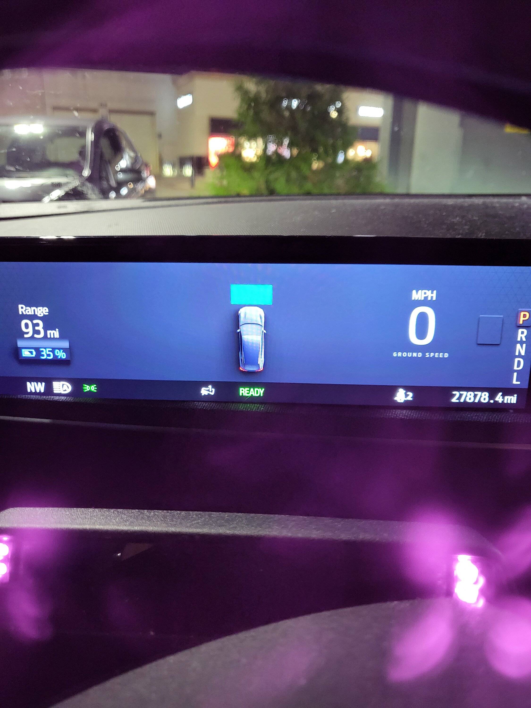

I'll preface this with I'm a 2021 Job 1 car (Not EA). I recently took my vehicle in for 21G01 to get Bluecruise. Everything looked fine but ended up having to take it back in today to get it to fully work. When they did the update today it pushed 3.5.3.3 to my vehicle. After the update, my UI screen behind the steering wheel keeps the vehicle icon as if I'm in cruise when I'm not. Normally it would have my speed in the middle of the screen. Is anyone else having this problem after 3.5.3.3? A pic of what is happening will be below. TIA

That’s the icon when you have the power on to Blue Cruise. Pressing the power button on the left side of the steering wheel should take that away.

Go into Settings > Driver Assistance > Pre-Collision Assist and disable Distance Indication.
Thanks, never had that turned on but when I received the car back this afternoon my profile was acting weird.

From what I gather on the forum, that's one of the ways to know your vehicle has 3.5.3 or later. ;)
