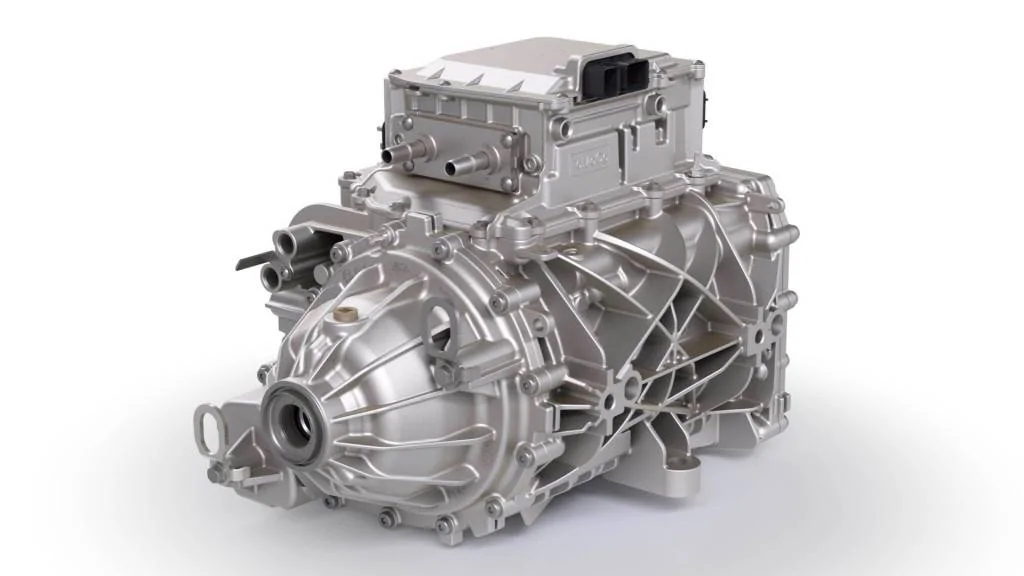

They definitely use the ISO symbol. It also looks like they've taken some weight out of the casing.

The 2021 Ford Mustang Mach-E electric SUV will take advantage of the system integration experience of transmission and drive-system supplier BorgWarner to free up interior space.
BorgWarner is supplying its Integrated Drive Module (IDM), which includes a thermal-management system and gearbox, packaged with "motor and power electronics from other suppliers," according to a company press release.
One engineering highlight is the use of a concentric design for the gearbox, with outputs on the same axis as the electric motor. This results in a more compact package, according to BorgWarner.
Versions of the unit are used in both rear-wheel drive and all-wheel drive Mach-E models.

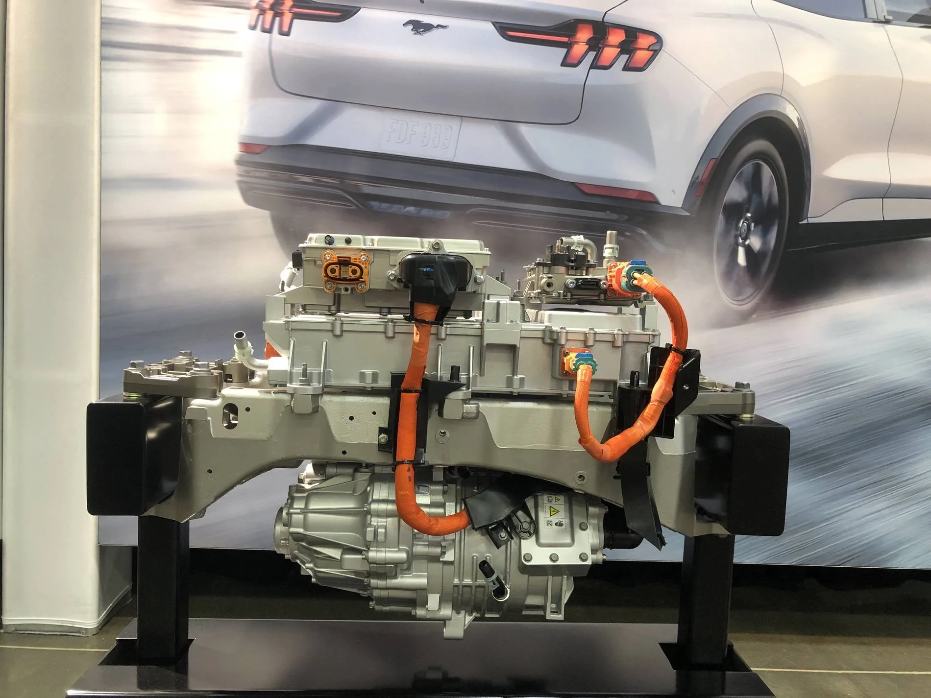

Well that's interesting. It says that BorgWarner has designed a new front motor for the GT.
Do you mean this sentence?
On the all-wheel-drive GT version, BorgWarner is supplying the secondary drive unit to power the front wheels as well.
I don't read this to mean a new front motor. It's supposed to be the same motor front and back on GT, though the packaging could reasonably have some differences (but who knows).

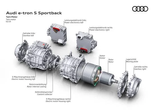

In time we should get more specification would be nice to see the width dimension of how wide the motor and gearbox are, hopefully the gearbox is pretty small and leaves room for a potential twin motor upgrade in the rear :) similar to what audi has done for the e-tron sportback s model
