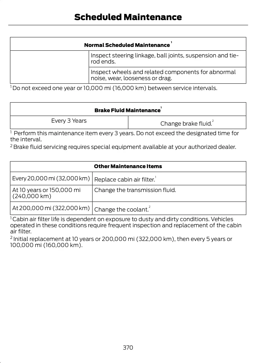

In my owners manual under Scheduled Maintenance, it shows to replace the brake fluid every 3 years.
Ford Mustang Mach-E Brake Pads and Rotors Owners Manual p370
......like I said, have them look it up on the official Ford.com site under Scheduled Maintenance. They can use your specific VIN or a generic year/model...or you can pull it up yourself on your Ford.com Dashboard They have since changed it to inspect only, not replace. Newer models also reflect this in their original manual.
