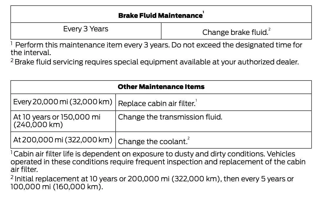

I was wondering what in the world y'all were talking about. I looked again at the maintenance schedule on the app and there is nothing about the brake fluid change.
So I searched the MY2021 Manual and found this on page 370:
Ford Mustang Mach-E Three Year Brake Fluid Changeout Screenshot 2024-11-29 at 9.05.01 AM
You find the same thing in the 2022-23 manuals.
However, the 2024 manual doesn't have these two tables.
The 36 month brake fluid doesn't appear in the maintenance items in the app. However, the "Other Maintenance Items" do appear at 20,000, 150,000, and 200,000 miles. ?‍♀
I guess I'm overdue for fresh brake fluid.
I noticed the same thing. It’s unusual that they wouldn’t list all items under maintenance schedule regardless if they are based on distance or time. My Mach-E has 13k miles after 2.5 years and it’s very confusing to figure out what’s due when.
